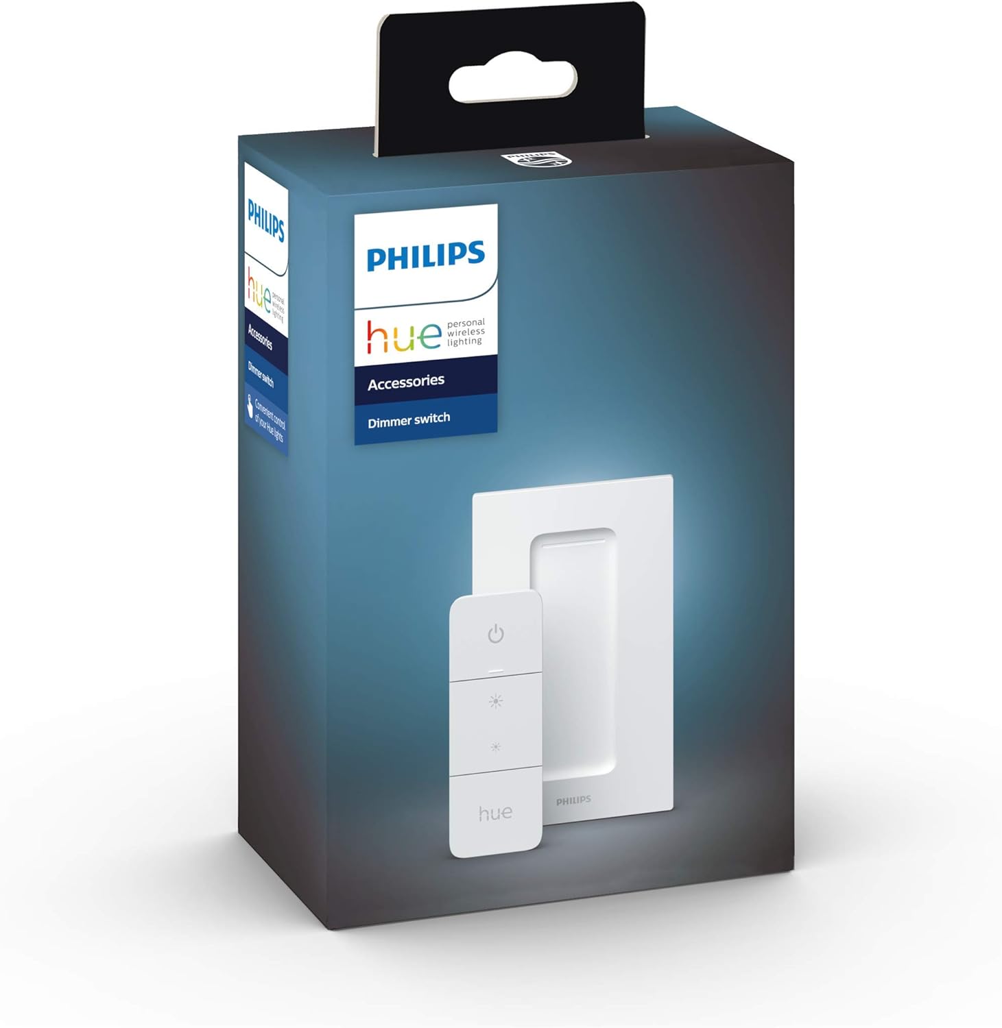

Posts: 1715
If you have a Philips Hue and a Hue hub you can buy a switch that turn the light on with a button press. It takes 2 or 3 seconds to go dark to full on the dimmer adjust bit. Works in parallel to any fancy app control.
We have one on our hall lights as it avoided chasing in switch cables. Works fine all the time, even when the phone app has an off day.
Apparently you can also get Hue to talk to Alexa and any other smart system.
Link below. Ours has the dimmer on 2 buttons not 1 but probably just this year's model.
https://www.argos.co.uk/product/8817680?clickSR=slp:term:philips%20hue:6:79:1

Posts: 1715
The Hue dimmer switch doesn't need the hub to be on to work, according to Philips (see FAQs)
https://www.philips-hue.com/en-gb/p/hue-dimmer-switch--latest-model-/8719514274617#faq
The Hue app can have rountines programmed into it. There is also a sunrise and sunset feature that may do your circadian rhythms thing.
https://www.philips-hue.com/en-gb/support/faq/apps-and-software#How_does_the_SunsetSunrise_feature_work
Standard software will probably do 80 or 90% of what you want and something like if this then that will do the rest.
I should admit that we use few of the features. We turn our on, off and dim it using switch or phone depending of what is easier.

Posts: 1672
I'd be interested in finding out how he has done the Circadian rhythm bit - I've seen it done by connecting Hue to Samsung Smartthings or Apple Homekit, am sure there are others as well.
With the other bit, I'm assuming that he has set up either a switch like this Hue Smart Button:
Hue smart button
or this Hue Smart Dimmer (that probably looks like a programmable box):
Hue smart dimmer
Both work in the same way, by setting the On button to cycle through 4/5 different "scenes". You do this in the Hue app. So that's probably what he's done. He could change it so that only 1 scene triggered the Circadian effect and all of the others were the emergency one, but that's a bit hacky.
The thing is, that a hue bulb needs power going through it all of the time, so likely there is still the old light switch somewhere near by. In the Hue app you can set what the default "On" state is - this is so that if your less technologically inclined household members just use the switch you can make it so that the default isn't BRIGHT WHITE. As this is actually the behaviour you want, then I would stick the Hue dimmer or button next to the old light switch and label one "Circadian Smart Lighting" and the other one "TOGGLE FOR EMERGENCY LIGHTING", and call it a day.
The whole thing sounds a bit mad though. I hope the NHS hasn't paid this guy to put in a Hue Bulb and switch.
