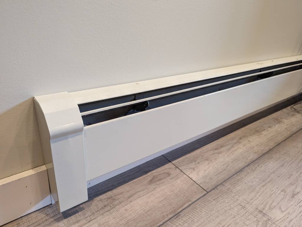

My gran had them in her house. It was always hot as hell in there, so they definitely emit heat.
We exclusively have weird, badly fitted, hydronic baseboard heaters now (apparently it's a North American thing), which seem to work for the modest space, but they do feel like cheap shit. The ones my gran had seemed of better quality.
