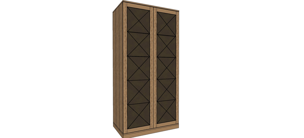

I'm making a wardrobe that has a decorative nail pattern to the two doors. There are a LOT of nails and they all have to be spaced evenly to a given pattern.
I've drawn out the size of the panel in Sketchup and then drawn a series of lines and crossing lines that I wanted to get CNC cut with an engraving tool so that I could use a bradawl or something to poke through and give me the exact nail position.
Wardrobe
Nail pattern and engraving 'map' for cnc machine
The trouble is, I am going to export the sketchup drawing but there doesn't seem to be the option to export it as a file type that a cnc will understand, stl,dxf,dwg and so forth. I only have jpeg and png available as far as I can see.
Does anyone know what I need to do in Sketchup in order to achieve what I want, and does anyone know the best format to achieve what I want to be able to give it to a cnc company to cut?
It might be something to do with making things components or groups or something. Can't remember.
I am using a free Sketchup version. I've always used a free version and in a previous work life I used to export drawings from it and cut them on a cnc router. I just cannot remember how!
The wardrobe so far if you're interested.

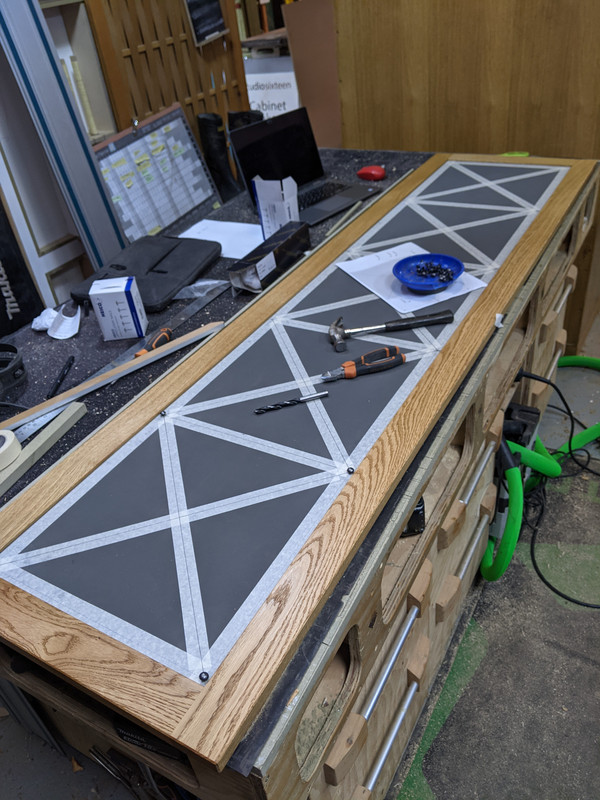

I'm a bit done messing about trying to do it with computers now and have just gone ahead and started to mark it out the old fashioned way by hand!
It'll no doubt take me ages but probably a similar ages to messing about with blummin file types and cnc and all that.
Cheers 👍
The panel is around 1800x370mm and the pins are 13.8mm centres so it'll take a while.
