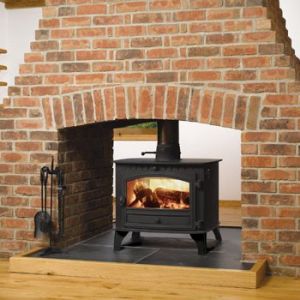

Alpin, another option (which I'd be giving serious consideration) is that you could knock through the fireplace between zimmer 1 and 2 and fit the stove in the gap between the two so it would heat both.
You could also put an eco fan (or similar) on top pointing into whichever room you wanted more heat on that particular day.
Posted : 12/11/2012 10:56 am
Posts: 12993
nice idea sharkbait, but not sure what the landlord would think when we start removing that much brick work... besides, the door open onto that wall and the opening between the two rooms is large as it is...
