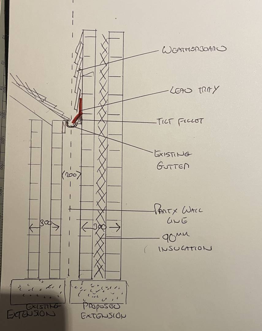

Just had a sketch through from the builder which actually seems a pretty decent solution:

I'd be a bit miffed about the short notice, it's pretty cheeky to want to start within days when you would be well within your rights to ask a surveyor's opinion. But at least the builder has attempted to address the issue of damp running off into the gap.

Is that existing guttering up to the extra load?
Posted : 26/02/2025 10:08 pm
Posts: 2582
He's going to be jumping about on your roof to do the work above the gutter, I'm surprised a stronger fibreglass box gutter has not been specified by the architect, your plastic gutter and brackets might be aged and brittle
Very awkward to replace if in a few years it fails and needs replaced
Posted : 26/02/2025 10:09 pm
Is it ever going to be possible to repair or replace the guttering?
Posted : 26/02/2025 10:13 pm
Doesn't appear to be an architect involved here. But I'd agree with the need for something bombproof.
Looks to be receiving just what hits the vertical boarding side-on and runs off, so not sure it would be a vast extra load. Unless OP lives in Scotland.
Posted : 26/02/2025 10:43 pm
Posts: 13942
Amazingly there is an architect involved. I spoke to him yesterday and his response was basically "it's not ideal but there's not a lot you can do to stop them"...
There will be a small amount of access between the houses to get to the guttering using crawl boards on our slate roof. I think the suggestion about replacing the rather flimsy existing guttering with something more substantial is good idea. We do have issues with there being a very strong wind tunnel between the houses down the shared drives, so if we're unlucky and get something similar in this narrow gap we could have winter storms pulling off a gutter that's very hard to fix back in place.
So if we have the guttering replaced with something with much larger lifespan, and the combination of lead flashing and new gutter can keep the side of the house dry, then the 20-30 year lifespan of the render shouldn't really matter. Does that sound logical?
I need to check how high the more waterproof outer course of blocks go on that side of the house - the other side of the house is uphill so I remember it went quite high to stop water on the drive getting into the house. I presume we should ensure that the space between the houses at ground level is shaped to act as a drain taking the water away from each wall and then out to the open space at the end.
Would some kind of mesh across the open end to stop anything like leaves/bird/animals getting into the space but allowing airflow be sensible?
We live on a hill on the south east coast of England - I haven't been to Scotland for quite a while but I don't think our weather is quite as wet but it's not exactly dry and recent winters have been very stormy.
Posted : 27/02/2025 11:17 am
Posts: 2582
I'd want a box gutter sitting on strong brackets or corbelled brickwork so it's fully supported and rather than leave a 200 mm gap between the buildings built up close with a 1/2" mastic joint almost like an expansion joint with slip ties to give it strength so you can keep vermin out that 200mm gap. It could easily be vented with slim vents every 450 vertical
Next door would have had to get drawings passed for pp and BC so why has the architect/technician not detailed this part? Rather than the builder does what suits him

my house is built like this. the previous owners and next door didnt get along. It hasnt caused any issues that ive noticed, though roofing the extension was a fiddle.

the builders sketch looks good, not just because theyve got a plan, but theyve drawn a neat and clear sketch. They know what theyre planning, and it suggests they know what they are doing in general. Youd be lucky to get a scrawl sketch from some builders

The builder highlighted a crack all the way up the middle of our render on that wall and he's offered to re-render that FOC and if it proves to be a crack in the actual blockwork he said he'll also insert steel ties to stabilise the wall before re-rendering. He seems quite a reasonable chap. I think we just need to agree a really durable guttering solution. If their wall is block can they add corbelled brick? Or will the exposed tops of the brick create a potential entry point for damp on their side?
I agree about the architects drawings - surely they must have designed the new wall to take into account it can't be rendered? And as part of that they should have detailed the solution for our wall. I'll ask the builder what detailed drawings the architect provided, if any.

I would be using a much more substantial guttering system, no way would I be using the existing in that situation. Something along the lines redmex is talking about with no joints ideally and capable of handling significant future rainfall.
A lot of existing guttering systems aren't sufficient for the deluges we can experience now, let alone in the future
Ime people are incredibly blase about the effectiveness and water tightness of their guttering, yes you may get away with it in a conventional situation but in this instance you are creating potential problems. Throw in a bit of moss and a few leaves, you've got overflowing gutters and standing water in no time. What happens in a typical UK winter where a few inches of snow falls, then rapidly melts - the gutter will fill with slush, the melt can't get out and just tops the guttering and goes between the properties.
If you spend any time at all working on roof/guttering/lead work you will know that fast running water off a roof is quite something to see. Details matter, and if you get it wrong the water is firing up and bouncing off in all directions and down the walls.
In addition I would be wanting some sort of draining at the base of the gap - that way any water that managed to pass the guttering isn't going to soak the ground. If you are careful you may be able to install something that could be kept clean. A French drain perhaps or channel system. Make sure it's covered temporarily while blockwork is done, you don't want it filled up with mortar that's dropping out the back of the new wall as it goes up.

Think I might consider getting the heavy duty guttering attached to their house, with your roof draining into it. Makes future maintenance their problem.
