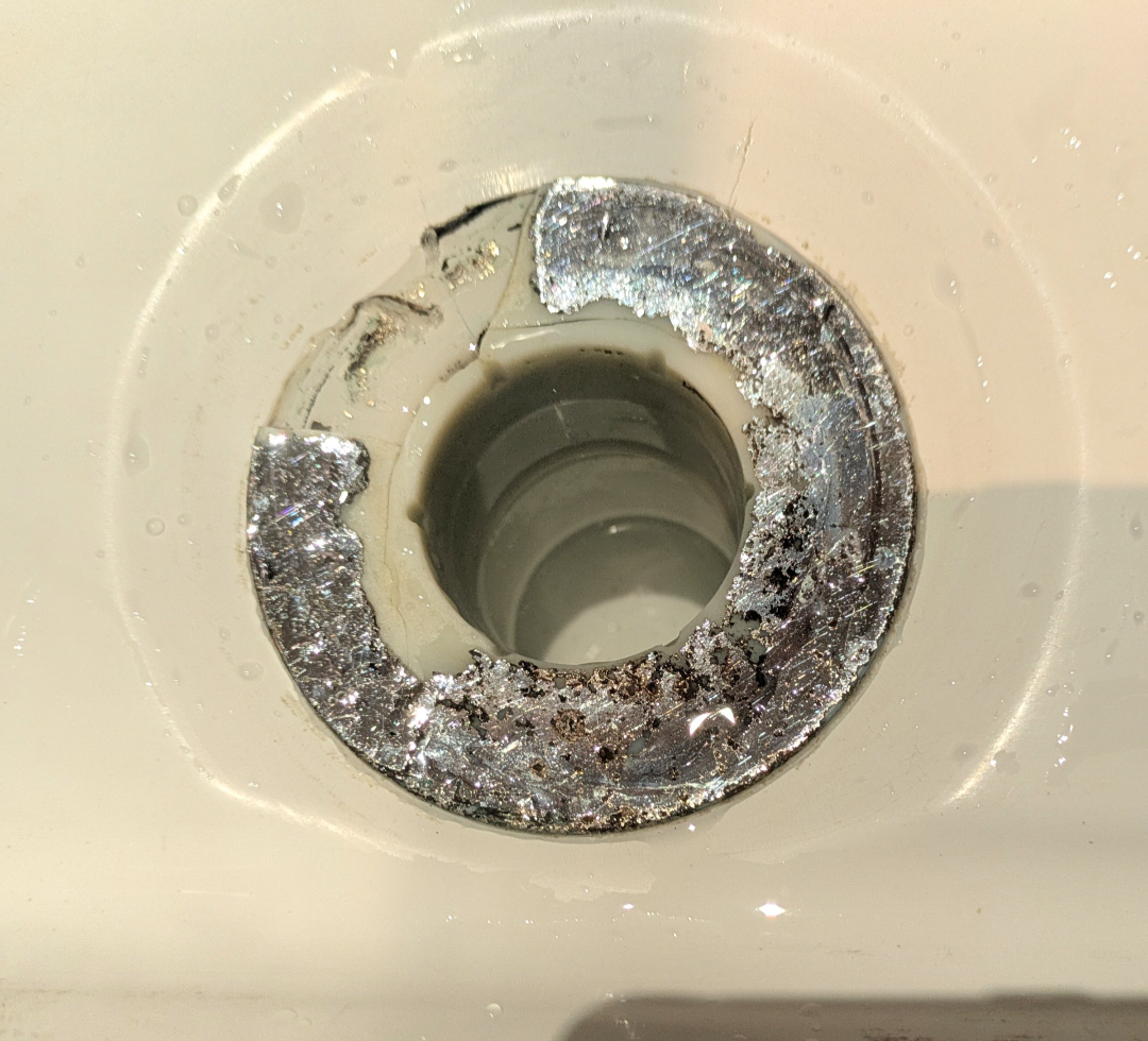

So, this shower has been slow draining forever. Despite repeated plungering, chemicals etc It doesn't have a removable hair trap like our other shower and I'm not sure if it's been removed or lost by the previous owner or missing by design.
Had another go today, and this cap has cracked and the chrome finish is borked as you can see.  Can I just remove this collar thingy and replace? If so what tool do I need to remove it? I initially thought the little divots were to accept a BB type tool (can you tell I'm not a plumber) but they are for the top cap to rest on.
The plastic is obviously brittle so any force is going to shatter it and presumably it's fixed with silicone or plumbers putty. Is there a tool I can get from Screwfix or the plumbers merchant?
Can I retro fit a hair trap? The ones I've seen are all for larger diameter drain holes, this is only about 41mm diameter.
And finally, how do I access the drain hole to get a flexible rod in to clear any blockage. It's not visible or accessible at the bottom of the visible part of the drain.

Looks well cracked now, id look at replacing it.

I thought so when I read 70mm dia, but in the comments it says the actual tool bit is 44mm so it might fit.  It says it for a "McALPINE STW Waste Top".  I googled that and the dimensions look very similar to mine, so I may take a punt on that tool, thanks 👍
Yep absolutely, replacement is the plan if I can remove the old one.

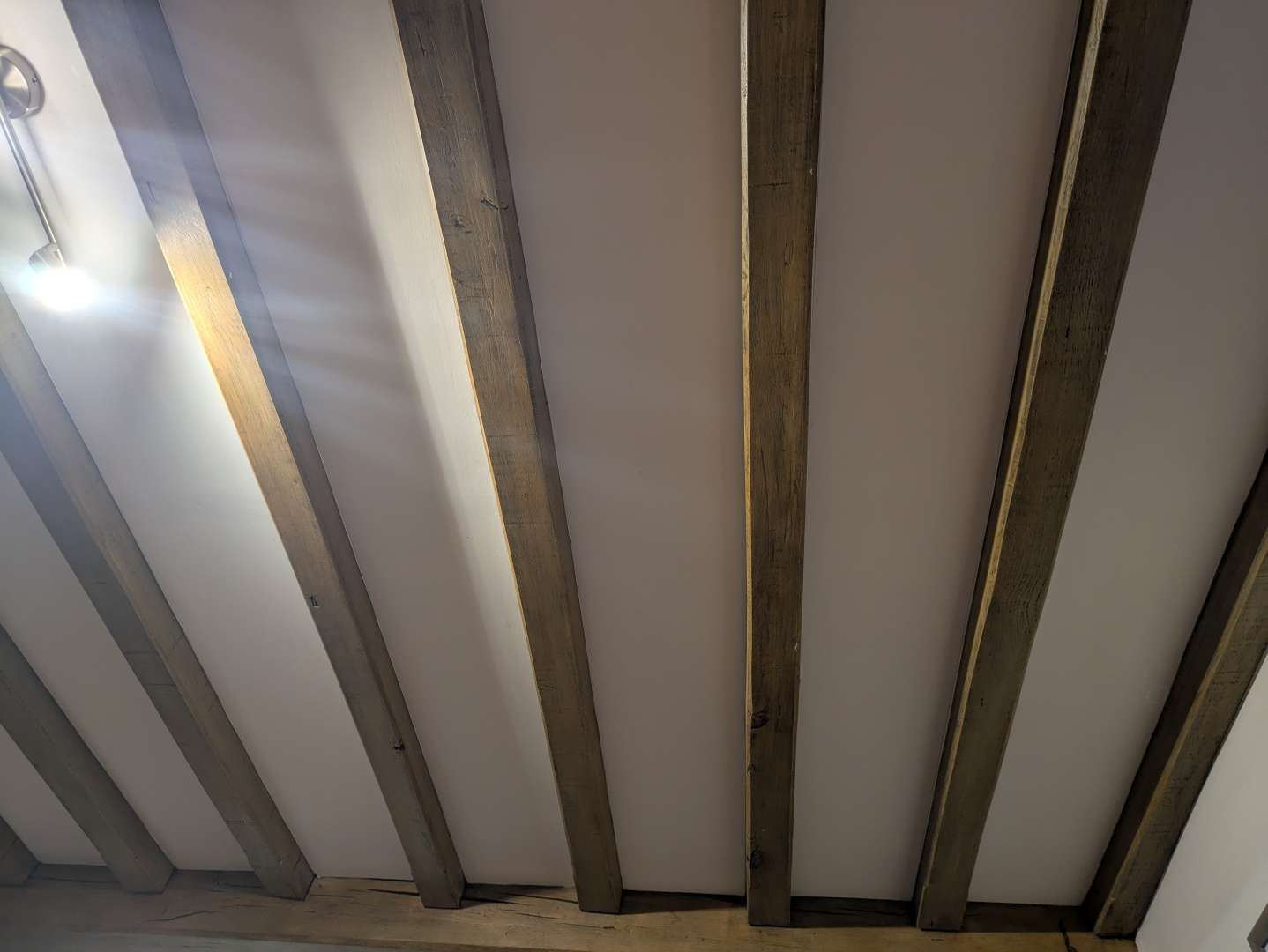

what is below shower? Is there a ceiling to cut an access hatch to get at it? Had to do this to our ensuite shower, thankfully its above the garage
Posted : 07/06/2025 8:35 pm
Posts: 5128
Open plan kitchen/dining/living room. With wooden beams on the ceiling. You just know the trap is going to be right above one of the beams instead of in one of the gaps right?
Posted : 07/06/2025 8:42 pm
Posts: 905
Posted by: blokeuptheroad
Even if it is, there'll still be a gap that you can work in. Though cutting through two sections might make working on the pipework easier.

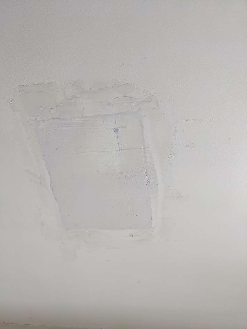

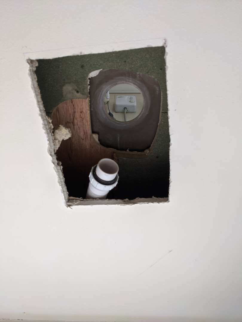

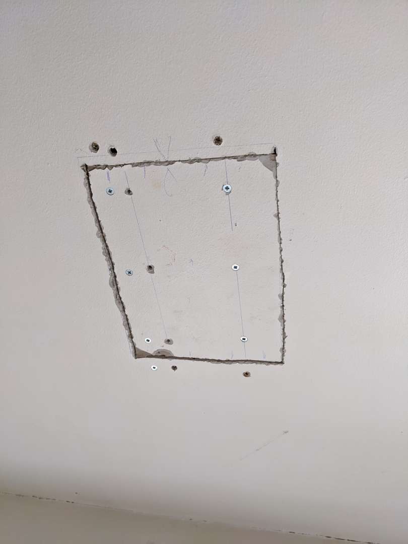

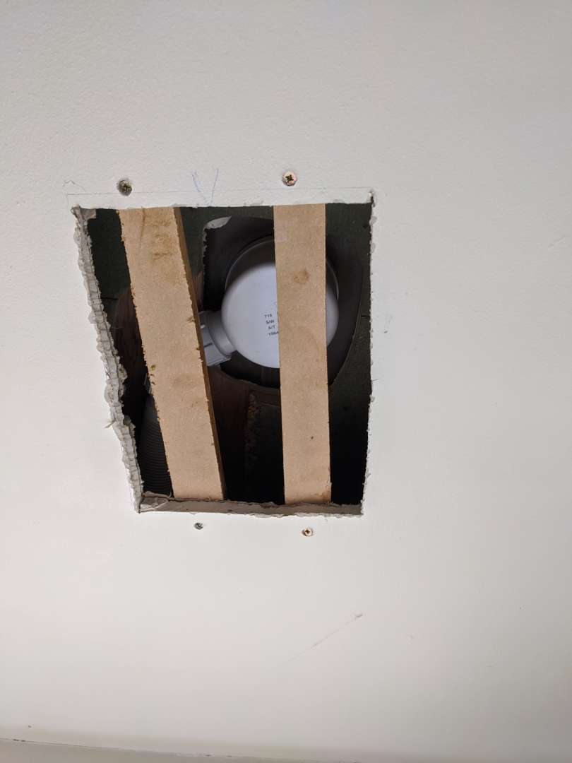

I had to replace our shower trap a few years ago by cutting through the kitchen ceiling, and I found it a pretty straight forward job, once I had everything I needed
IMG_20200609_134843.jpgIMG_20200609_150758.jpgIMG_20200609_160328.jpgIMG_20200609_162803.jpg

Scrim tape the plasterboard to help prevent cracks.
Posted : 08/06/2025 8:47 am
Posts: 905
Probably should have, but it's still OK after 5 years. It's right in the corner of the rear extension, so there probably isn't much flex in the ceiling at that point.
