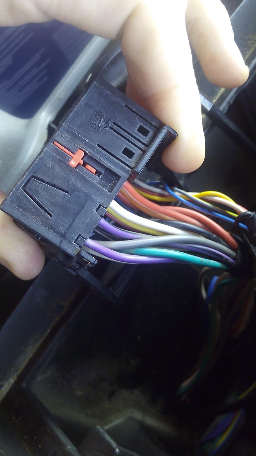

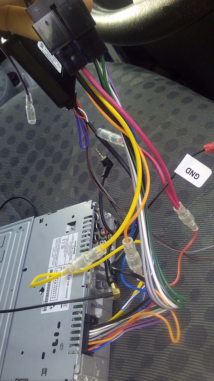

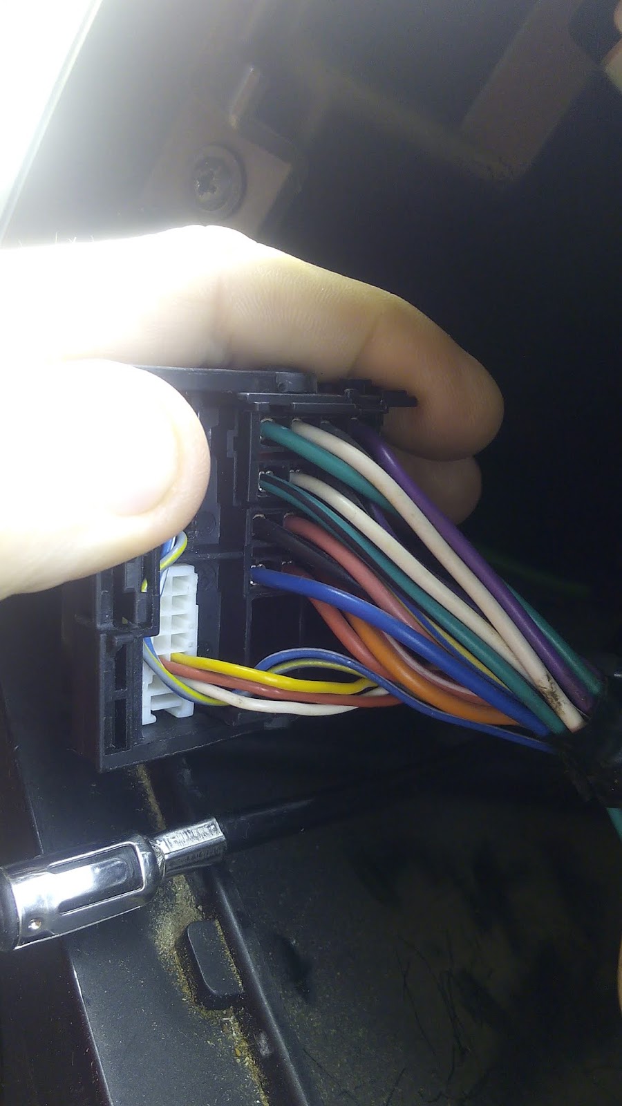

Trying to fit a new DAB radio to my van. Apline CDE-205DAB to a 2013 Mk7 Transit.
Got it mostly working, even the steering wheel volume control. However, the old one would work without the ignition on, the new one won't and I would like it to.
There is the connector with lots of wires which is part of the van. There is also the one with many fewer wires which goes into the back of the radio, also fewer than went into the back of the old radio, I guess one of the missing ones must be the permanent feed.
So, can I work out which is the permanent feed into the old connector and connect this to the ignition feed in the new one? Or maybe run a feed from either the fuse box or battery (easy, under the driver's seat) into the radio? I have a 10a inline fuse, same rating as the main one in the radio itself. Any better ideas? And which wires are involved? The manual suggests that the yellow one should come from the battery but this fits somewhere else.
Ive got some pics of the connector, the new radio and the manual.

Blow it up at your own risk as I'm not a sparky but the red will need to be on a permanent live for the radio to work all the time. Linking the red wire to the yellow should do it.

The yellow is permanent feed and red the switched live, so linking the red to the feed supplying the yellow will allow you to use it with no ignition.
If it isn't storing the settings etc when off, then the yellow wire isn't connected to a permanent live and will ultimately be easier to put a new fused supply in direct from the battery. Then connect both red and yellow to this.
Looks like you have an autoleads or connects2 wiring adaptor in there so should all be relatively easy to play with.

Back in my T4 owning days I had to swap the switched & permanent live feeds round when fitting an after market CD player. Your red & yellow cables will pull apart at the clear bullet connectors. Pull them apart & swap them over.
