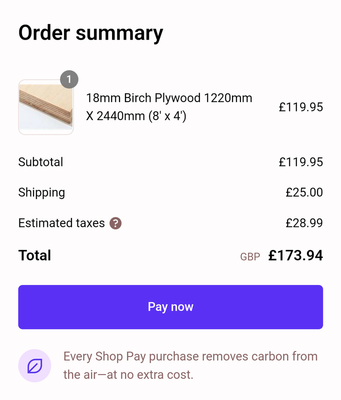

Proper birch ply furniture grade is just over £100/sheet(8'x4') or double sided veneered mdf, veneered in oak or any other hardwood, including exotics. Standard oak is about 80-100.
Posted : 04/12/2022 11:10 pm
Proper birch ply furniture grade is just over £100/sheet(8’x4′)
I wish 😊. This is one of my suppliers. Half hour drive away or delivery.
That's not even 'furniture grade'.
You sometimes luck out and get at least one lovely face but usually it's patches both sides at that price.
