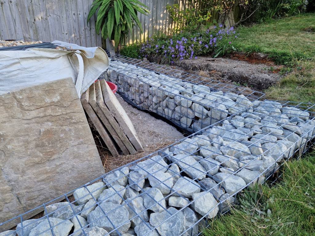

I've just done the same with left over Gabion baskets.
You can order custom sized baskets to suit the height you need to make up.
If the low end is at the fence, happy days you can just fill them with what ever hardcore you have lying around, as they are out of sight.
If the low end is visible, face them with a few bags of nice rock and backfill with hardcore. Weed membrane fabric over the back and backfill/level with soil.
https://www.gabionbaskets.co.uk/
This is faced with hardcore behind, just finished yesterday so the lids are not wired shut yet.
Posted : 03/07/2023 7:20 am
