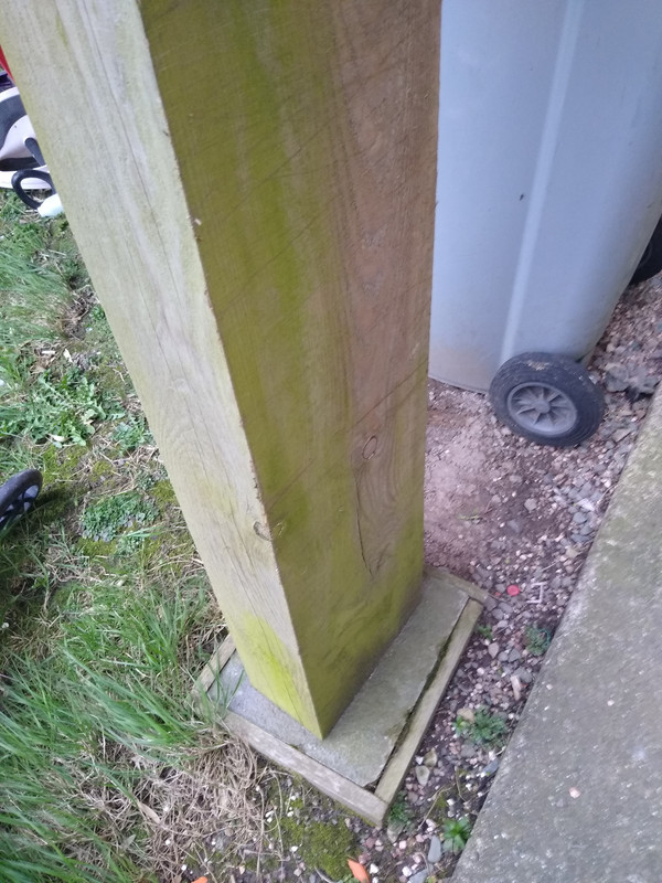

Posts: 7423
i remember being impressed with jambo's shed when i was looking to build mine a few years ago. it made more sense for me to dig post holes, put a bit of gravel at the bottom for drainage, then stick 4"X4" posts in.
i filled the holes with soil around 6 of the posts, but used postcrete on the 2 posts next to the field just for added strength against some off the hoolies we get blowing up the cliff and across the field. its survived a few storms over the years 🙂
i used a raised 'ring beam' for my floor, covered in decking for the gazebo section, and OSB for shed section. finished product here.
i went through the whole process from design to finish with lots of help on here, so every thought process and picture is in this thread, it may help if you had any of the same issues as i had to raise my floor due to uneven/sloping ground.
the pics start on page 3.
