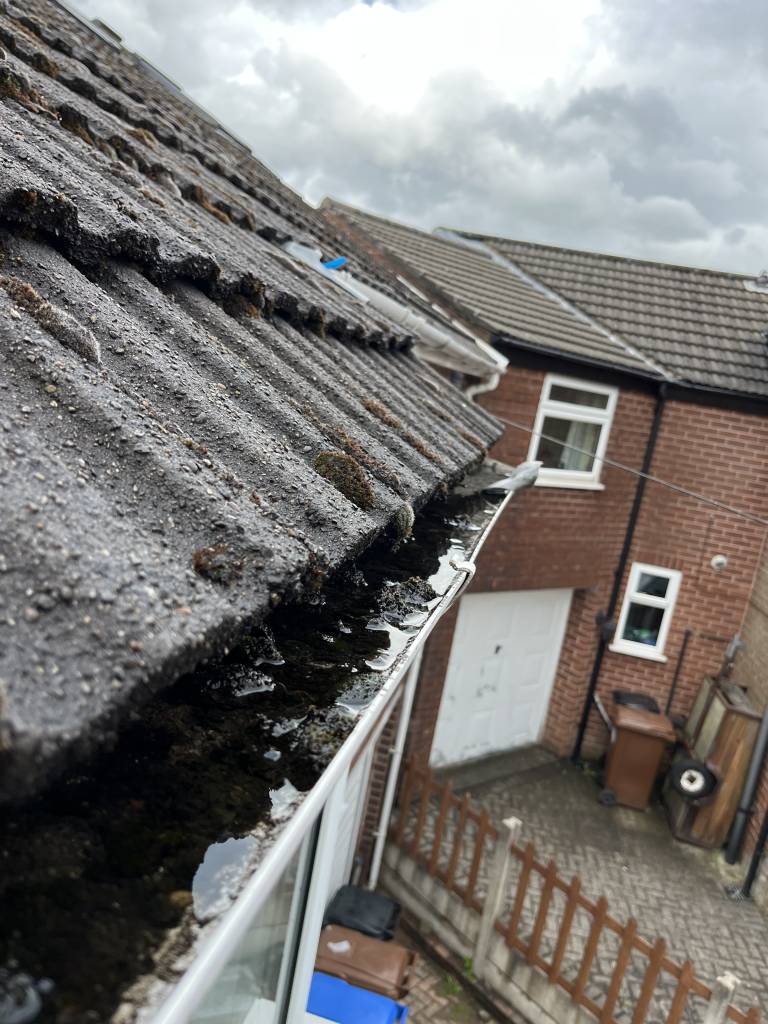

Water's been dropping from the guttering for a bit, so I got up to look at it this weekend. The issue is that the gutter is full of water as it's running away from the downpipe, towards the end stop.
It's doing that because the fascias are sagging (I know but saggy soffits made for a good title), maybe because whatever it behind them is rotten. I can move the whole soffit / fascia thing a couple of cms just by pushing it up.
Question is who do I get in to look at this? A roofer? A builder? There do seem to be firms who specialise in doing soffits / fascias etc, so maybe one of those?

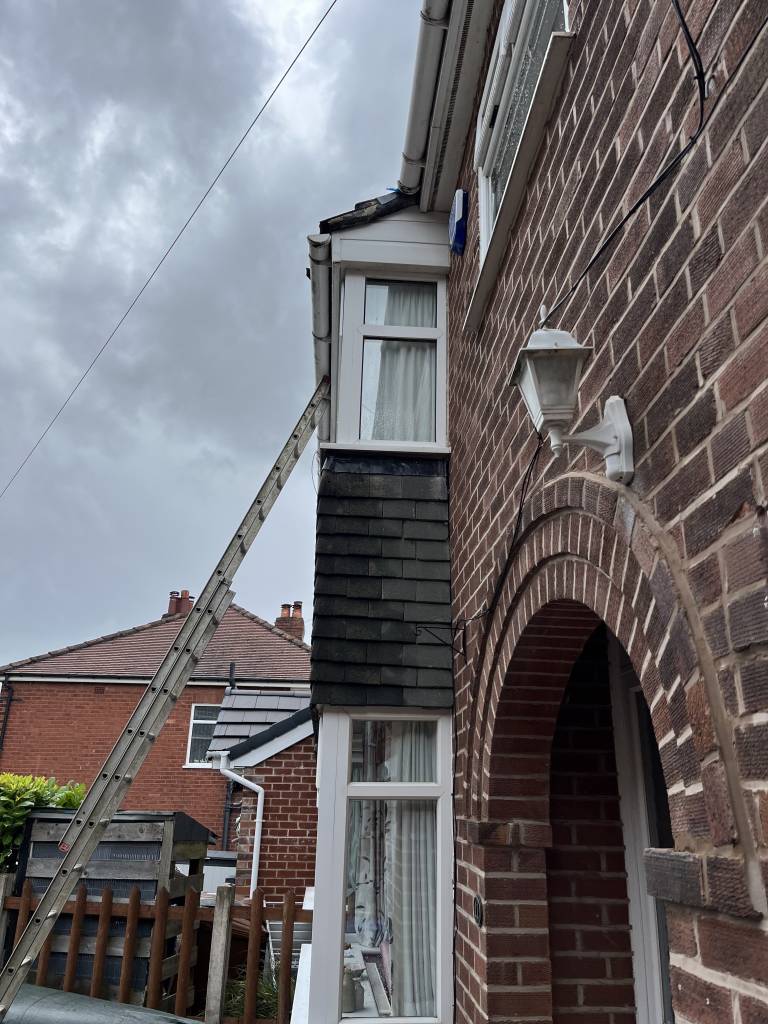

House is 1959. Not sure on the construction, but suspect a thin layer of plastic fascia over timbers. It's also above a bay that I know is brick at ground level then tile-clad timber between the two sets of upvc double glazed windows.
Saggy guttering
Saggy gutters from ground level
If I could upload a video, I'd share it - you can see the plastic of the fascia moving as I press up, which suggests to me that the issue is not the whole structure sagging, more that the plastic is no-longer securely attached to the underlying timber because it's rotten. Indeed, on the second pic above you can see that the fascia seems to leanout at the top Checking that ot from outside will mean dismantling the whole gutter / fascia boarding, I'll see if I can get at it from inside the loft later. Oh joy, lying on all that insulation wool :/

First of all empty all that crap out of the gutter.  the weight of it probably really isn't helping.  Looks like a lot of debris in there.

Yeah I moved most of the crap out after taking that photo. THere's a random piece of lead flashing in there, not sure where the heck that came from but itdoesn;t bode well...

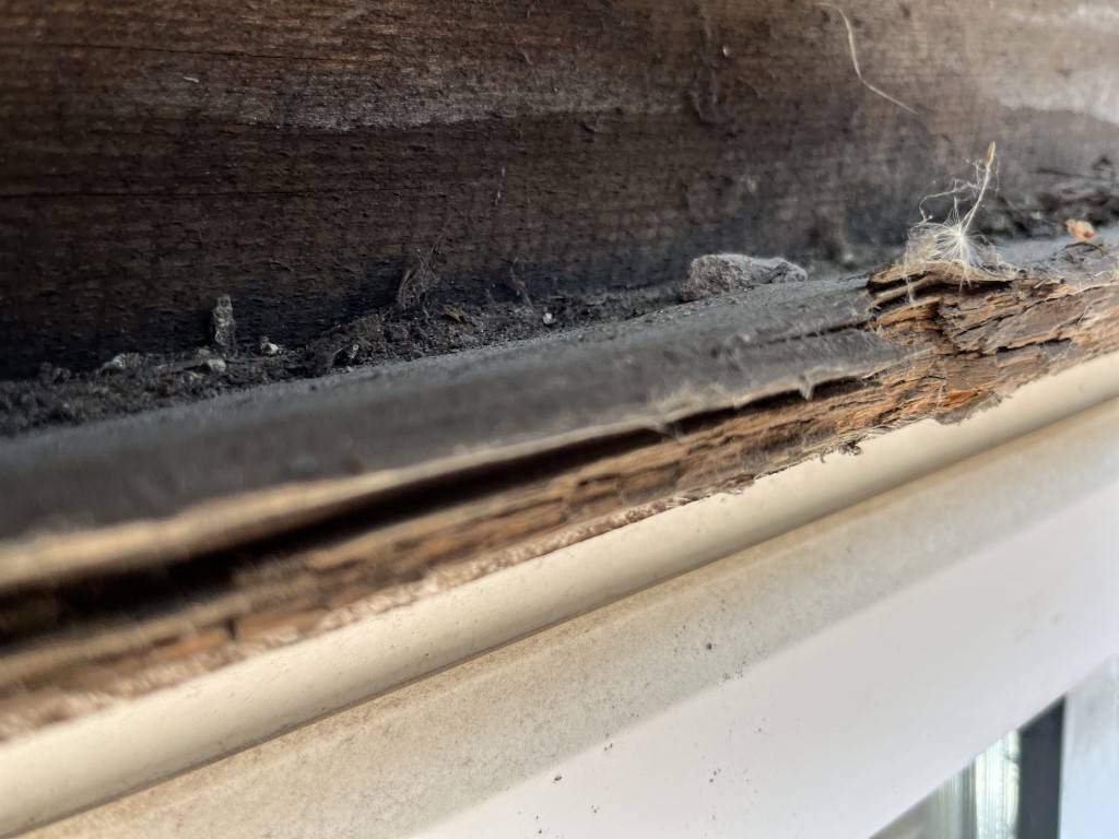

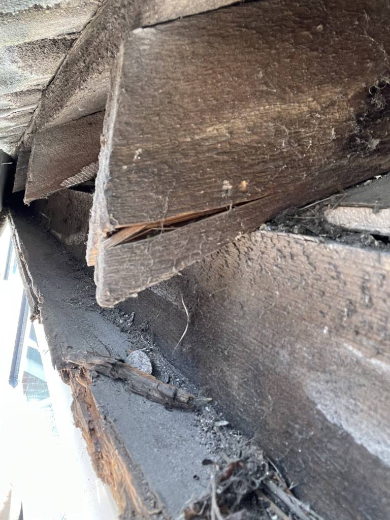

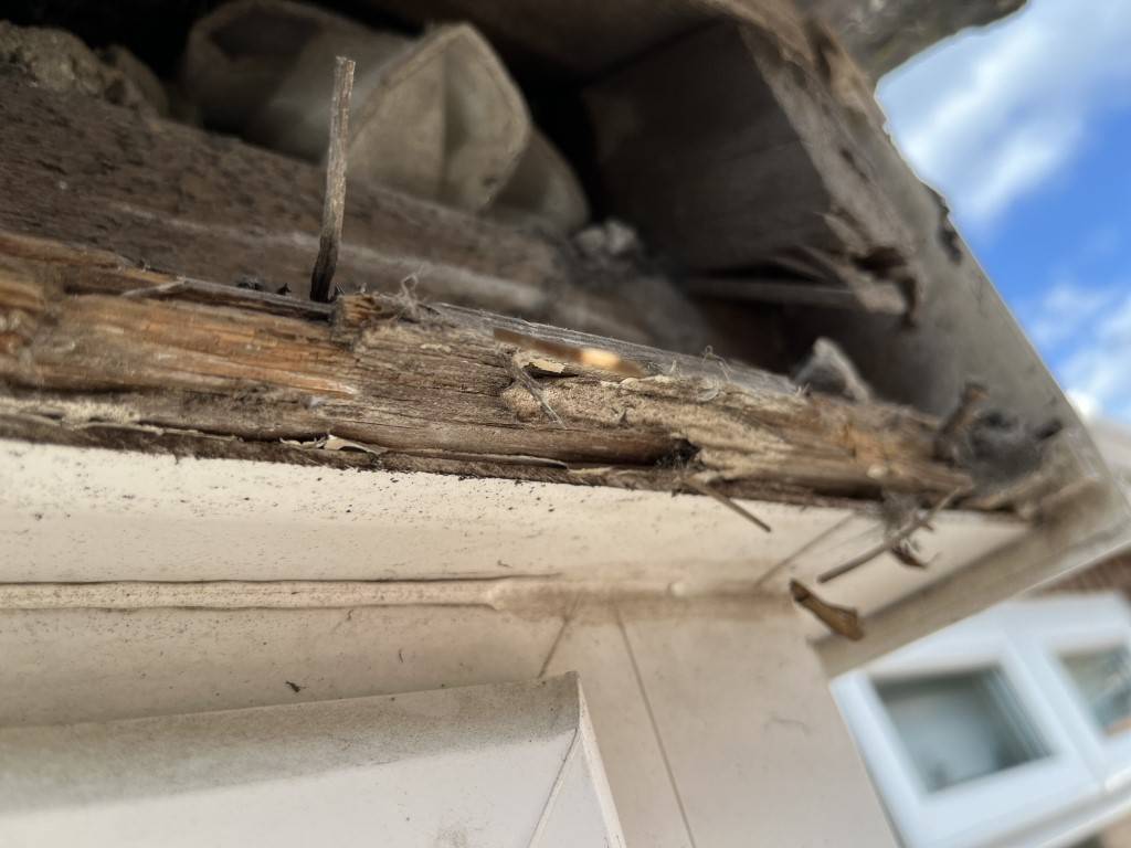

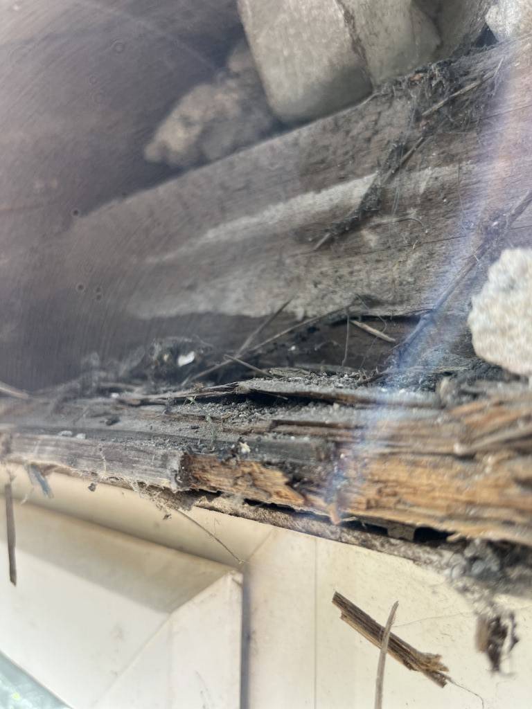

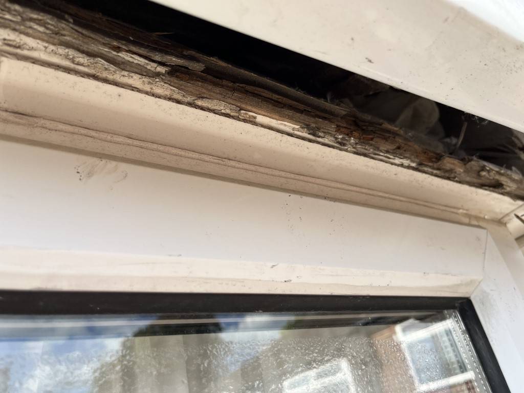

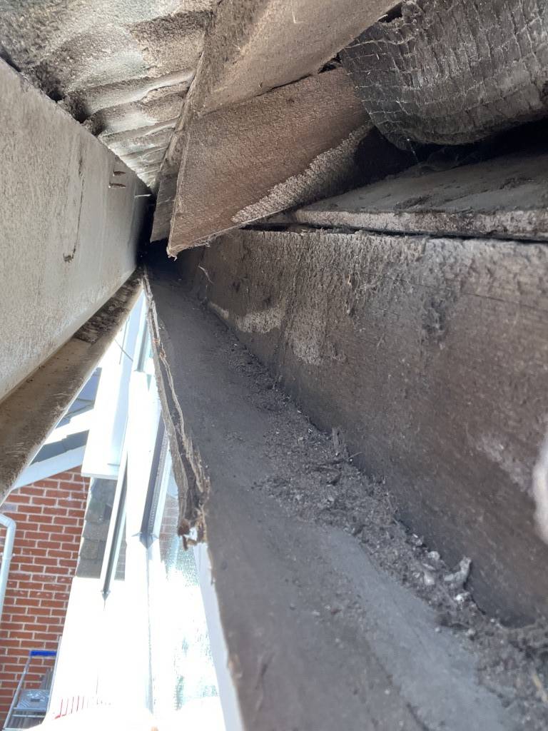

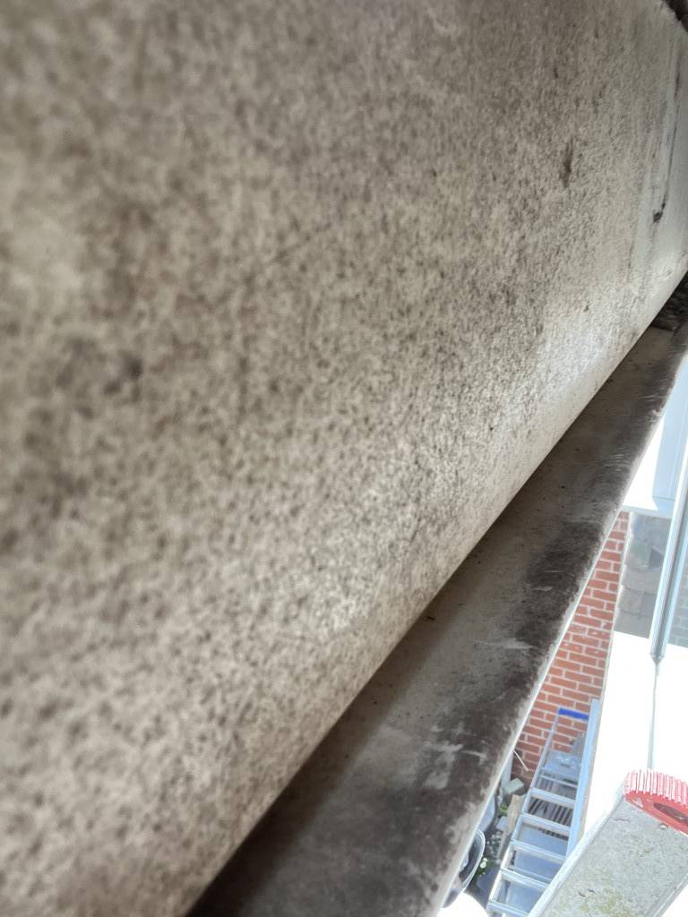

Oh  yes, time for an update. I got up and took the gutter off and cleaned it, then had a look behind the plastic fascia. The fascia just pulled away by hand for a large part of it's length, about half was firmly attached
Rotten wood
Hmm, that's definitely rotten
Yep, rotten wood
Yep, rotten woodMore rotten wood
More rotten wood
Yet more rotten wood
Yet more rotten wood. You can see here the rafters are splitting at the bottom, but they felt fairly dry and solid
Look at the INSIDE of the fascia
This is an odd angle, it's actually reversed - it's looking at the INSIDE of the fascia. It looks like the plastic fascia is attached to the (original?) wooden fascia board, which has become detached from the rafters
Looking at rafters
This shows the rafters where the fascia SHOULD have been attached. This rafter and the one just behind me at this point (the one at the end of this bit of roof) are the only ones to show damage
Continuedin next post...
Posted : 18/08/2023 1:52 pm

Right then, the quesiton is what do I need to do now? I've reattached the fascia a little more firmly, so it's not sagging quite as much, but when it runs the water stil does drip (rather than pouring as it used to).
Do I need to get a roofer in? Or a soffits and fascia specialist? Or just a general joiner / carpenter?

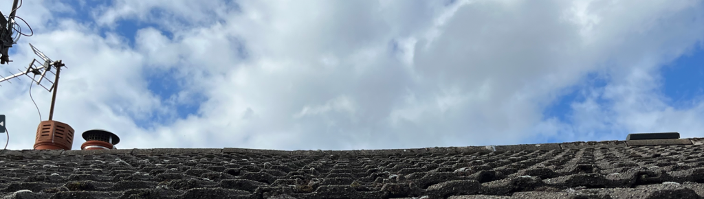

As I finished putting the fascia back, I did notice a very slight dip in the ridgeline
Dip in ridgeline
The rafters in the attic all feel dry - but might this be related?

Having worked for a window fitter I will try give you a plan of action. Assuming that you are going to DIY the job. Get a stand off adapter for the top of the ladder. Push the second row of tiles up (usually odd ones nailed) use a hammer shaft to do this. Lift the first row off and place higher up out of the way. This gives you access to the roof timbers. It's looking like yours are just overclad so you need to start again I'm afraid. Rip it all off including soffits. Sort out timbers if needed. Lay soffits on top of the bricks and nail the outer edge inline with the outer edge of the timbers. Fit the new thicker facias. Fit new felt guard up to the first tile lat and under any felt that's not rotted away. This channels the rain water into the gutter and is important. Fit the gutter back. Go for a couple of pints 👍
