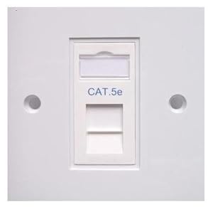

Drill a hole and use these at either side - brush faceplate

 xora
Posts: 950
https://www.amazon.co.uk/kenable-Plate-Sockets-Single-Keystones/dp/B003OSYWWM/ref=pd_cp_107_1
2 of those back to back (ish)

[quote> https://www.amazon.co.uk/kenable-Plate-Sockets-Single-Keystones/dp/B003OSYWWM/ref=pd_cp_107_1
Pretty much. There's 8 wires, all colour-coded. You'll need a [url= https://www.amazon.co.uk/gp/product/B000Q5KLN0 ]punch-down tool[/url] also.
Forget CAT6. It's more expensive, harder to work with and completely pointless for what you're doing.

Actually that brushless faceplate is a great idea. I have two tv's back to back to it will enable me to run several cables through should I need to...
