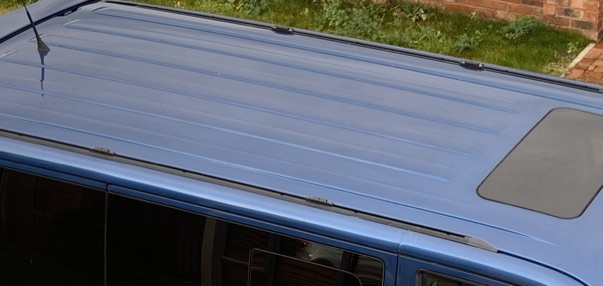

Tricky one this - my Vivaro Life has the mounting points, which makes foot availability good, and with mounts you are unlikely to damage the paint - mine won't take roof bars as the rails do indeed mount to the points, but my version with a sunroof, doesn't have the rear mounts, so no rails.
You've potentially got extra cost of rails, cross members and adapters feet than just the bars and adapter feet.
Speed of fitting will be another issue - not so sure which would be faster.

Fossy - is yours the same as my crew-van with just 4 sets of threaded holes (roughly above the sliding door)? If so, I think lack of the rear mountings might be more to do with the tailgate rather than sunroof.
To the op - if you can get brackets and bars that screw straight to the mounts in the roof, it might be quite quick to remove / refit once initially set up (depending how much the bars obscure the roof bolts).
The Berlingo roof rails have also slimmed down on the facelift version of this model (maybe chasing aero improvements on the EV). Shame they don't do like the original Berlingo where the cross bars were always there, built into and hidden under the longitudinal rail and just pivoting out when needed.

@mick_r Yes four points around mid roof area. Tailgate.
