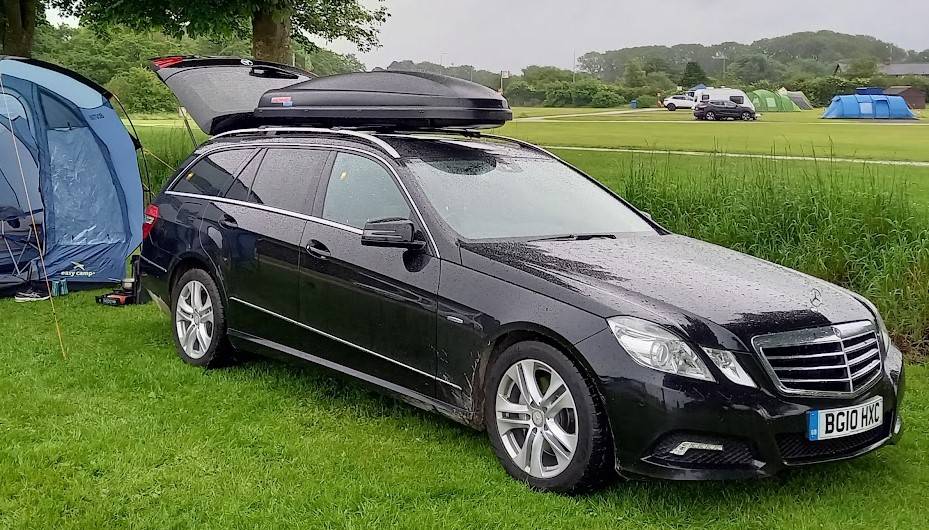

For the box, I have a Kamei long and slim version - again, a deliberate choice:
A) it takes all our 'long' camping things, windbreak, folding chairs, folding beds, folding pushchairs etc...
B) less frontal area, more aero = quiter, less/negligible effect on mpg.
C) can fit it on one side and still have room for a bike.
D) crucially its much, much easier to store - it fits between the standard 600mm centre rafters in my garage and thus I can shove it up in the loft, on my own unaided.
Note how low the box is to the roofline of the car. And its not a small box either, the rather  large car is misleading!
Again this shows the profile of the bars and why they are so quiet and efficient. Will be doing 2000 mile roundtrip to Switzerland next month and I'm very comfortable in the knowledge that once we are loaded up and sat inside the car, there is negligible/no noticeable effect on noise or economy with this setup. Which is a good job as I predict we will be taking a LOT of stuff!

I think I’ve got the same box as @snotrag - Kamei husky 300 (previously called the husky M I think) or something like that. It’s a long / narrow one. I bought it so if I need to I can fit that on + a bike just about. I’ve got Thule wingbar edge - because they looked tidier then bars that hand over the edge of the foot pack etc.
Stays surprisingly quiet on the motorway and I can get quite a lot in it. If it wasn’t for storage and wanting the bike on I’d still probably have got a kamei - but a wider one.
Mine was mainly for camping where a beer fridge and massive tent take up a big chunk of the boot of my Jaguar XF. I still fitted in a load of stuff around there but the box swallowed the windbreak / multiple fold up chairs / electric hook up / Weber Anywhere bbq / roll mats etc etc.
