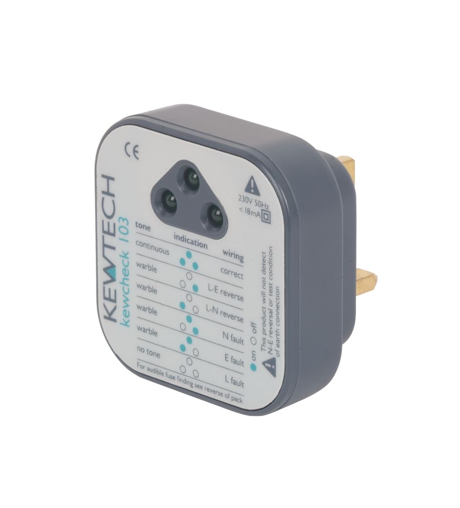

When you say ‘seems to point’ to the socket and that the appliances ‘just don’t work’ ….. you’ve plugged them into another socket and demonstrated that they actually do work I take it. (And you’ve plugged things that you know work into the suspect socket too)
Posted : 21/12/2021 4:48 pm
Yup, those plugs are brilliant wee things. The cheap LAP ones in Toolstation are just as good.
Posted : 21/12/2021 4:52 pm
The best bit is their alarm which sounds when they are live, can leave it plugged in as an early warning alarm in case something goes live when I'm working on it. Plus I have switched the wrong circuit off and then wondered why my arm is shaking whilst working on a ceiling rose...
I paid a lot less than the Screwfix price on the 2nd one!
Posted : 21/12/2021 4:55 pm

To clarify, those appliances that have been in the rogue socket now don't work anywhere, even with good fuses fitted to them.
The rogue socket is definitely live, other appliances do work in it, but I have only run things for a very short time.
Looks like the socket tester is a good first step.
Posted : 21/12/2021 6:29 pm

As well as the socket tester, there's a really useful little LAP tester to see if current is running through a circuit. It's not accurate enough to isolate exactly which cable if there's a group together, more expensive ones would work better for that, but it's been really useful to me for wiring things up, finding faults or double checking you're not about to zap yourself.
EDIT - I bought the socket tester and little pen tester thing for about £12 combined from screwfix a few months back - offer is still on https://www.screwfix.com/p/lap-ac-non-contact-voltage-detector-pen-1000v-ac/3222g

Posts: 118
Thanks for all the input, some possibilities there.
Here is the result.
I have used one of those LAPP testers in the socket, and it gives the 3 lit LEDs which means "Normal". The tester would have told me if there was No neutral, and other faults.
I would have been happy to check the neutral connection in the socket if that had been the fault, but I have done what I can, and never intended to get further into the house wiring.
So have wrapped up now with a suggestion that they get in a qualified electrician if they are still concerned.
Happy Christmas everyone.
