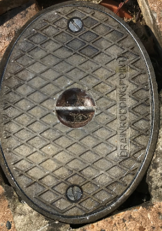

I'm trying to undo these screws to gain access to the drain but they are not budging any ideas?

WD40 and an impact driver
Posted : 24/03/2020 11:59 am
PlusGas and harsh language.
Posted : 24/03/2020 12:12 pm
Posts: 384
As it happens, I've just done that. Maybe put some boiling water on it then repeat I think.
Posted : 24/03/2020 12:15 pm
Posts: 8306
Heat is your friend. Blow torch?
Posted : 24/03/2020 12:21 pm
Posts: 2582
Very carefully take the whole aluminium end off, I can see a bit of the plastic socket . Just watch and not drop stuff down the pipe. Judicious hits with cold chisel then rubber mallet but watch your not lifting the orange pipe out next socket

take your time and try to avoid whacking too hard - its cast and may crack.
Heat a good idea and candle wax melted in whilst hot - it seeps in and down the threads when its warm.

Kettle of boiling water over it.

Resorted to an impact driver, screws turning with that but still can't do it by hand. Should they fully unscrew or are they 1/4 turn ones? Don't want to smash them...
Posted : 26/03/2020 12:10 pm
Posts: 384
OK, the answer is they screw all the way out. Impact driver for the win! Thanks all.

Now for the messy bit and always read up how to use drain rods, don't do the screws up tight maybe some lube
