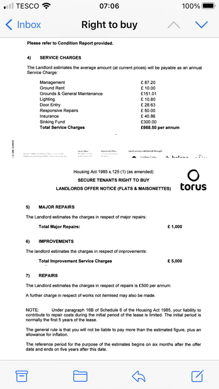

My Dad has lived in his council flat for 30 odd years and has just been given a right to buy offer on it. Valued at 96k and he can have it 28.5k which is a no brainer. However he works as care assistant on not great money and is just turning 66 and could retire next year. The rent he pays now is about £350 pm. He has about 5k he could put towards it but needs to raise the remaining £23k
Does anyone know whats the best approach to finding the money. Will he be able to get a mortgage at his age? On affordability he could easily do it. Even paying monthly what he pays now he could clear it in 6 years. Could I guarantor it somehow if needed? I’m even thinking worst case I could take a loan for it and he can pay me back the amount he pays now in rent? Just wondering if anyone has dealt with a similar situation or can offer advice?

I'd be digging a bit deeper.
The 'profit' sounds great but is it really worth £96k?
• What are the other flats like.
• Is it in a good area.
• As the owner he'll be liable for repair costs - can he afford those.
• Can he pay the mortgage when he retires.
• Can he cope with increased payments if interest rates rise.
• It will become an asset if he ends up in care so could be swallowed up in care costs.
At a certain age there's a lot to be said for being under council care.
And sorry to be blunt, but it sounds like the real benefactor of any property value would be you, not your dad.
Posted : 21/01/2022 10:55 am

May I ask why he has been given an RTB offer? If he's lived in the flat for that long then he could have bought it a long time ago through RTB.
What The Muffin Man says is an interesting point, I have no doubt that it would be a wise purchase from a investment perspective but council houses should be kept up to a certain standard and receive regular maintenance. By purchasing the flat you will be taking on the responsibility for maintenance that would otherwise be covered in the rental cost.

As you mention it's a flat, I'm assuming it would be sold as a leasehold? Any ongoing charges (e.g. ground rent, service charge, etc...) to a freeholder to consider? Are there any arrangements in place for maintenance that might make this expensive, or difficult to deal with in some other way?
I ask this as my partner's mum owns the flat she lives in, and the management company that look after the block are a bit of a nightmare. Any work required has to be arranged through them, awarded to their pet contractors at, seemingly, way over market rates. And generally appears to be a half-arsed job. However, as the occupier has no direct relationship with the contractor that has done the work, any snagging or re-work also has to be arranged through the management company, which makes getting *anything* done very long-winded.
Posted : 21/01/2022 1:25 pm

Check with any other leaseholders if there are any major works/bills in the pipeline, you might find yourselves on the hook for £££ if you aren't careful.

It would be leasehold with a 125 year lease at £10pa
Below is the statement in the offer letter about expected costs from maintenance and repairs etc
I’ve no idea why the offer has come forward to be honest. I’ll try and find out a bit more on that.
The whole issue of the benefits of remaining a tenant are very valid and it definitely has made me reconsider if its the right thing, but ultimately its my Dads decision and just trying to help him with the money side of things. I’ll have a discussion though and put those points to him.
Suspicious cat is suspicious.
Council knows of big repairs coming and wants as many tennents in the block off their books as possible to minimise their exposure ?

Posts: 3149
That's why I was interested in the RTB being offered, you wouldn't usually expect a council to actively want to sell off its housing stock at a loss.
