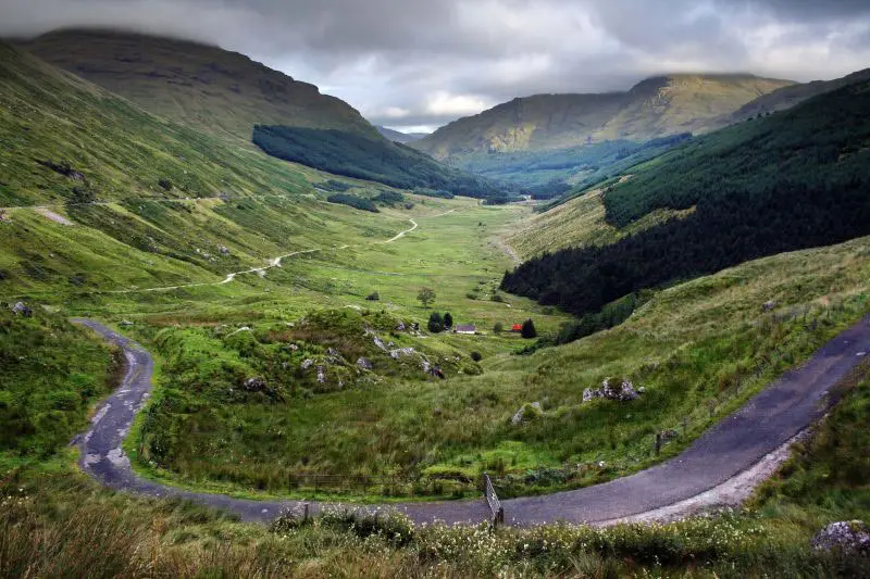

I’ve no idea where it is, but given how often it gets mentioned on the radio 2 travel news, I’ve no desire to go there.
It's a shite part of the world. I wouldn't bother.

It’s a shite part of the world. I wouldn’t bother.
Matt, your photo is the Last place I'd go to.

I think the difference at the head of the Glen is a less steep slope and also a short hillside above. There is a couple of thousands of feet draining heavy rain on to the current road. There must be a reason the old 19th century line of the military road is usually available as a bypass when the modern road is blocked.
Posted : 30/09/2020 4:21 pm
Posts: 1555
The line of the modern A83 (yep, closed again folks...) is clearly to maintain an even gradient from Laigh Glencroe farm to the Rest viewpoint. It does this very well but traverses an increasingly unstable slope in the process. Diverting west to ascend the valley floor on stilts solves the unstable mountain issue while allowing an even gradient to be maintained. It's the obvious solution but quite spendy, hence the batshit mental consultation process listing loonball or unaffordable bridges over Rhu Narrows, Loch Long (both downstream from nuke bases) or Lesser Cumbrae to kill the whole thing dead. They need to MTFU and accept the need for a sizeable investment to prevent a tragedy, which would trigger said sizeable investment anyway. If it took Edinburgh lawyers and politicians from their work to their But & Ben in Fife it would already have been built #Queensferrycrossing
Posted : 01/10/2020 1:48 am
irc
I don't know how true this is but a civil engineer colleague of mine told me that actually the military road gets damaged about as often as the main one, it's just that it's simpler/quicker to fix, and nobody notices as long as the main road is open. You only ever hear about a military road blockage or similar, when the A83's shut.
Posted : 01/10/2020 2:02 am
Posts: 1555
The OMR is much further down the slope. Most of the landslide debris peters out before it reaches the OMR. The August 5th slip was unusual in that it knocked both roads out, resulting in ferry trips for many of us. The downside of the OMR is uneven gradients and some tight bends that catch out artics, coaches and even caravanners.
