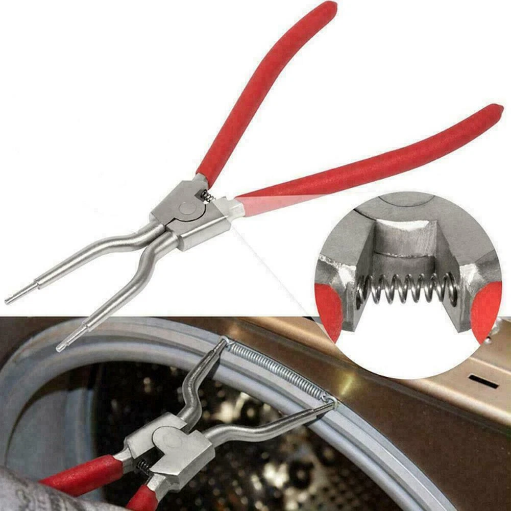

You can buy a tool to hold the springs which I think will make it 900% easier. Without that I think it is a "5 minute job".

Posts: 8306
@reeksy - Is this the thing?
Posted : 20/09/2024 12:37 pm
reeksy and reeksy reacted
Looks like it will work
