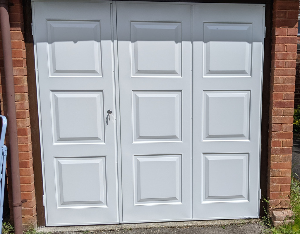

Big thanks to @mick_r for the suggestion of side hinged doors which had never occurred to me. I suppose because hardly anyone has them! Don’t see any round here anyway…except mine now!
Less than £400 off ebay from the Garage Door King (who else?😊)
Fitted with much assistance from my ex-wife’s bloke in under 2 hours (well, he did it, I did the removing of the busted up&over).
Perfect fit, easy when you know how. Certainly won’t be any security issues, for those gnashing their teeth at a 400 quid door. (I’ll probable add a shackle lock for when I go away).
Happy. Now to turn it into a decent bike store slash workshop.

That's the same as the cheap one I fitted but mines grey. Reinforce the lock plate at the rear if you can it twists very easily. Also the 2 shoot bolts work much better if you fit a strip of metal Infront of the hole you have drilled into frame/floor.
If you want to keep it clean get some car polish on it the spray and wipe stuff is great for cleaning doors
Nice tips. Cheers!
I almost bought grey, but it was an extra £50! 😀
