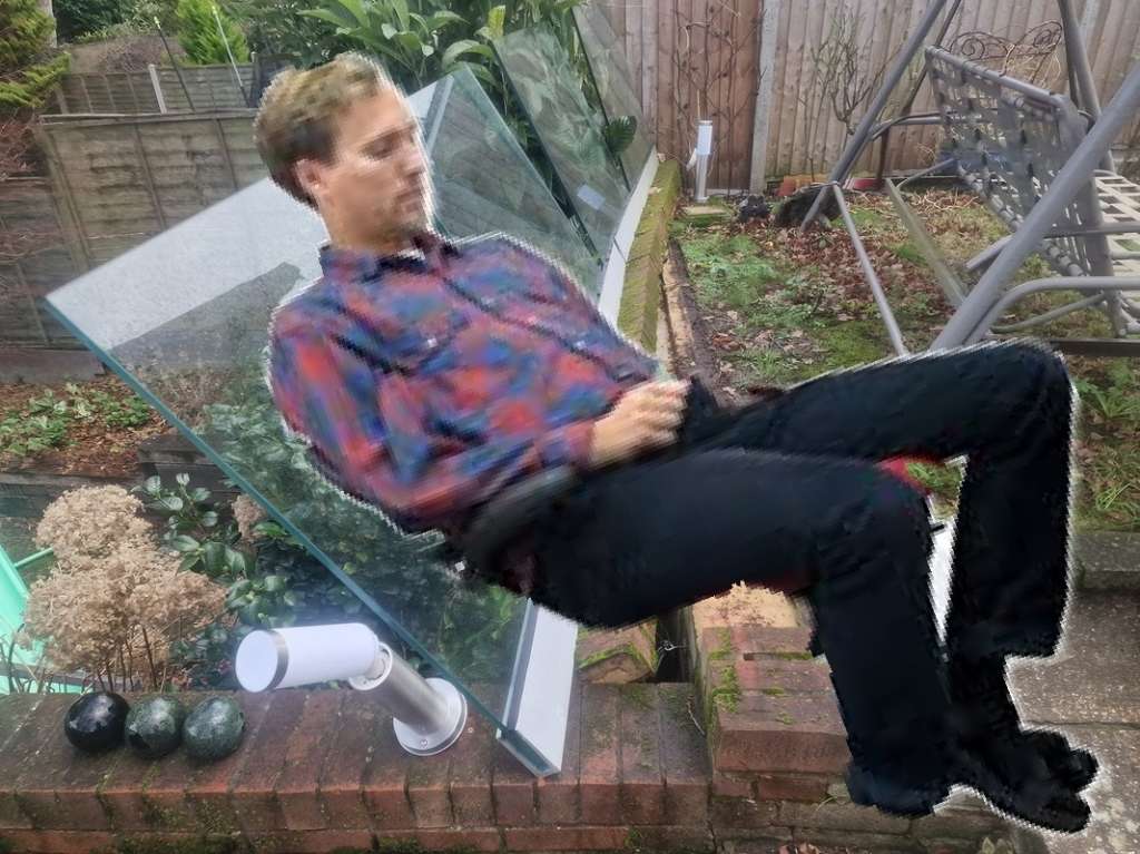

In the middle of storm Henk last night there was a loud clack noise in the garden and looking out this morning I can guess what it was. The big metal swing bench appears to have flown across the garden and wobbled the balustrade.
[url= https://i.postimg.cc/0ybpRccc/Fallen-Bench.jp g" target="_blank">https://i.postimg.cc/0ybpRccc/Fallen-Bench.jp g"/> [/img][/url]
Please ignore the weed. Any bright ideas on taking this apart ready to reconstruct it?
[url= https://i.postimg.cc/mZ9LqMYC/Fallen-Wall.jp g" target="_blank">https://i.postimg.cc/mZ9LqMYC/Fallen-Wall.jp g"/> [/img][/url]
The glass sheets are just about liftable individually but cannot be removed from the aluminium whilst it is twisted and under tension. I also do not want to break the expensive glass. The balustrade was bolted in place with bolts going about 1.5 bricks deep. The nearest bolts have been pulled out of the 2nd layer but further away you can see it pulled the second layer of bricks off as well.
I am thinking that if I can lift the broken wall, balustrade and all, back on top of the remaining wall then I will be able to deconstruct it more easily. Any ideas how to do that, or any better ideas?

Trolley jack under the bricks to lift them back up and shuffle onto the wall and then dismantle and rebuild with new brick and aluminium?
Or leave it where it is and angle grinder along the side of the aluminium to ease it's grip on each sheet of glass to make it easier to remove - then remove the bricks/aluminium and start again?

Cut the aluminium base where the glass meets so you only have to deal with x4 smaller sections?
Is attaching to brick ever going to be strong enough though? The glass is very heavy and the leverage on 1.5 bricks will be massive.

Can you get a small hoist, like and engine hoist on the end with the paving. You might be able to then move the hoist back and pivot the glass with bricks back on top of the wall?

Trolley jack is a good shout. I was thinking of a plank and leverage. [url= https://i.postimg.cc/xTt4Pfsh/Lift-Falled-Wall.jp g" target="_blank">https://i.postimg.cc/xTt4Pfsh/Lift-Falled-Wall.jp g"/> [/img][/url]
Cutting them into 4 might work but would look shit when I put them back together.
Have we been here before - Yes. It turns out that when the wall checked to see if it was strong enough, it was only checked in one area and that was bricks onto solid concrete. Unfortunately the rest of the wall base was not.

i like the idea of a trolley jack under the end bricks while someone is at the same time pushing the top of the glass back towards the wall where it should be.  The problem with the plank is that there are two directions of force.  One is lifting the brick up but the other is also pulling it away from the wall.  At a minimum if you use a plank you want to screw in some sort of stop to avoid the glass/bricks sliding further down the plank as you apply force
I had always wondered if 1 1/2 bricks in was enough for the fixings especially as you don't know if the bottom half of the fixing is gripping properly if it hasn't been cleaned out well.

I'm not sure the aluminium channel is going to be reusable - it may be - depends on whether it has twisted.  I've only handled this type of balustrade before, am i right in thinking the glass effectively just drops in and is held by the seals?
Sounds like a sure way to either bend the aluminium channel or break the glass - I'd be pushing/ pulling at brick level.

That was never going to work think applied mechanics and moments, if you never did this subject you may not have a clue what I'm on about but that height of heavy glass against one bed of mortar that looks like it's been infested by bugs and vegetation is like putting a heavyweight boxer against a flyweight boxer
I'm not a building engineer but served my time as a bricklayer and have an o grade in app mechs

And for the rebuild, 1m of threaded rod fixed with resin into the new concrete foundation for the new wall. It might be worth redesigning with gaps between or under the glass panels to reduce the wind loading a bit.

Aluminium channel isn't too warped as the glass has held it straight
Glass just drops into the channel and held in with spacers. There is a slight bulge in the aluminium where the support wedge in the middle of the section is under max load.
The balustrade was absolutely firm when put in, and for at least a year afterwards, I think that the gentle but repeated rocking in the wind cracked the mortar allowing the brinck to seperate, It is a little worrying that this is meant to be safe for use up to 3m off the ground.
The challenge with doing any pushing from the other side is that the ground is 5 feet lower and the bushes block access.

I think the best approach is basically several people.
Something will break if you only lift at one point.
The other option might be that now you can get rid of your swing seat, support the glass and you've got a ready made, contemporary garden recliner.

The rebuild will be something more solid. The bit that was checked before install was brick faced wall with concrete filling behind and soldiers laid flat on top. That was absolutely solid but appears only to have been used for the wall along the side of the garage. The rest was made with cheese. We had the wall along the drive professionally rebuilt when that collapsed, the bit by the garage was fine, so this is the only remaining original wall section.

Did you honestly think 1.5 bricks deep was going to do the trick? Was it it actually the storm or did one of your squirrels fart next to it.
That needs actually design to be safe not just half arsed*.

I’d get a piece of angle iron and put it on the underside outside edge of the bricks and lift/push that so you’re pushing it as a whole and not adding more twisting forces to the aluminium/bricks.
Jack the angle iron up maybe one panel in from the end nearest the camera and wheel/pry forwards to shimmy the whole lot on to the wall for dismantling.

I'm afraid you've gone form over function with that balustrade.
Going for a frameless system might look slick but it would have been stronger if you had fitted a 'standard' balustrade with vertical posts between the glass panels and a top rail.  The vertical posts could have been mounted on the face of the wall which would have been much stronger than mounting on the top as has been done.

4 x 2 joist under the dislodged bricks, high lift jack to gently raise the dislodged course up and then forward.
Then you need to coerce the bricks back to where they were originally.instastick should be enough to hold them very temporarily.
Then reduce the length to 3 panels, bury the rail into the mud on the side of the wall near the swing .
Use rubber strip between the brick and the glass.
Then get the wall rebuilt maybe with a pier for the 3 pane of glass.
Burying the aluminium channel and glass by say 30cm will reduce the wind load and massively increase the resistance to failure.
