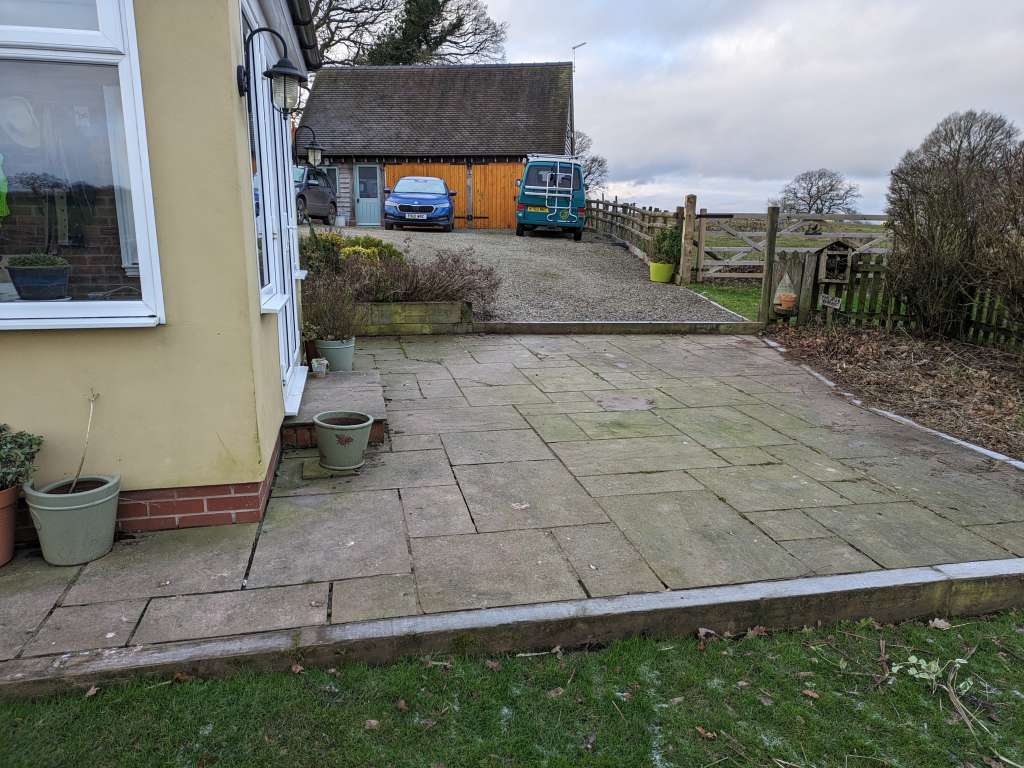

We have a patio area roughly 9 x 9m and there are a few places where the grouting/jointing compound is loose or missing. The slabs are textured natural stone and the joints are about 15mm wide. Previously I've used the stuff pictured with mixed results to repair bad patches. Pros - it's easy to use, it's a good colour match with the original grout. Cons, it's expensive and wasteful, as I don't actually need that much. Also, it doesn't seem to last too well as it's mainly the areas I have previously repaired that need doing again. Any suggestions for something different to use? Dry sand and cement mix perhaps?

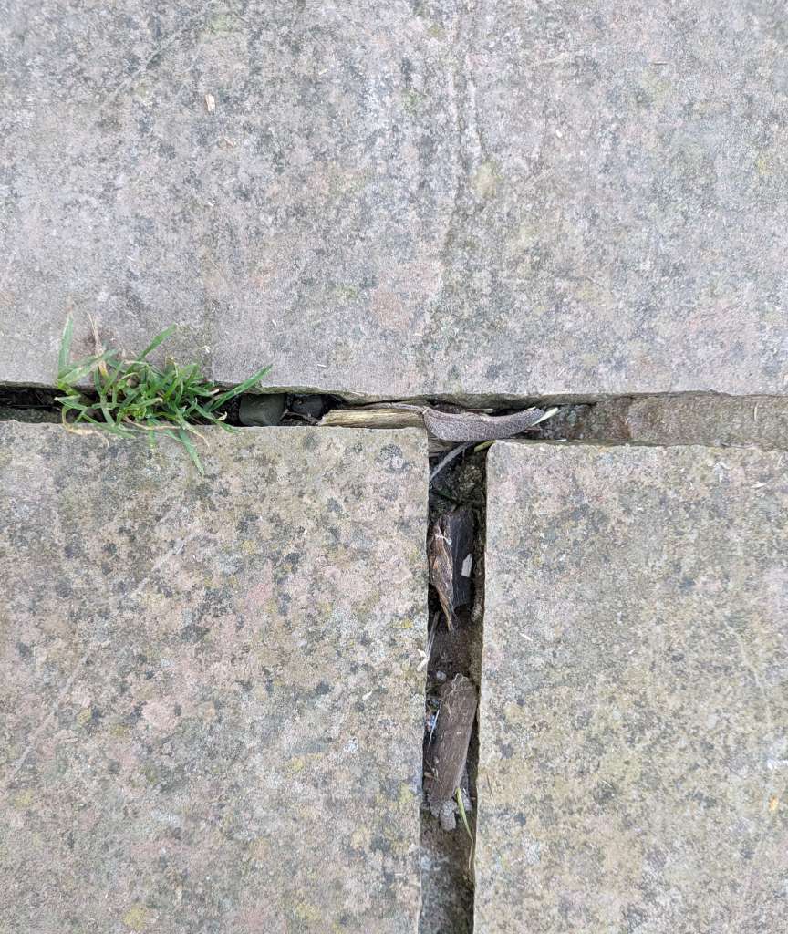

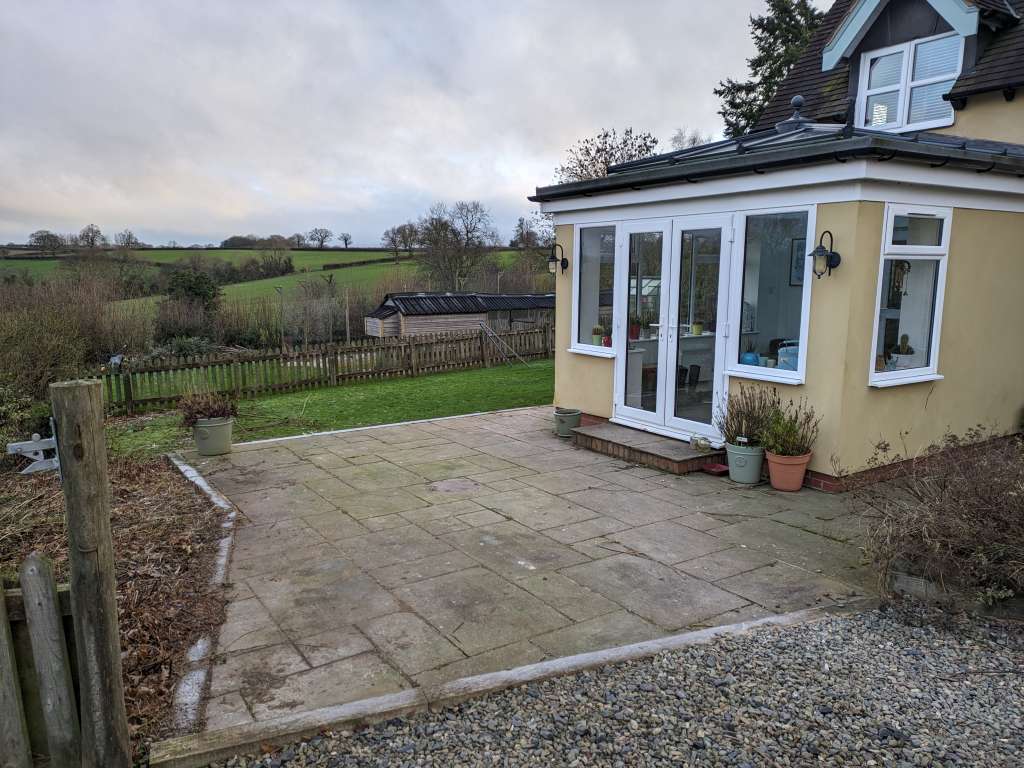

Some pics. Be kind!
