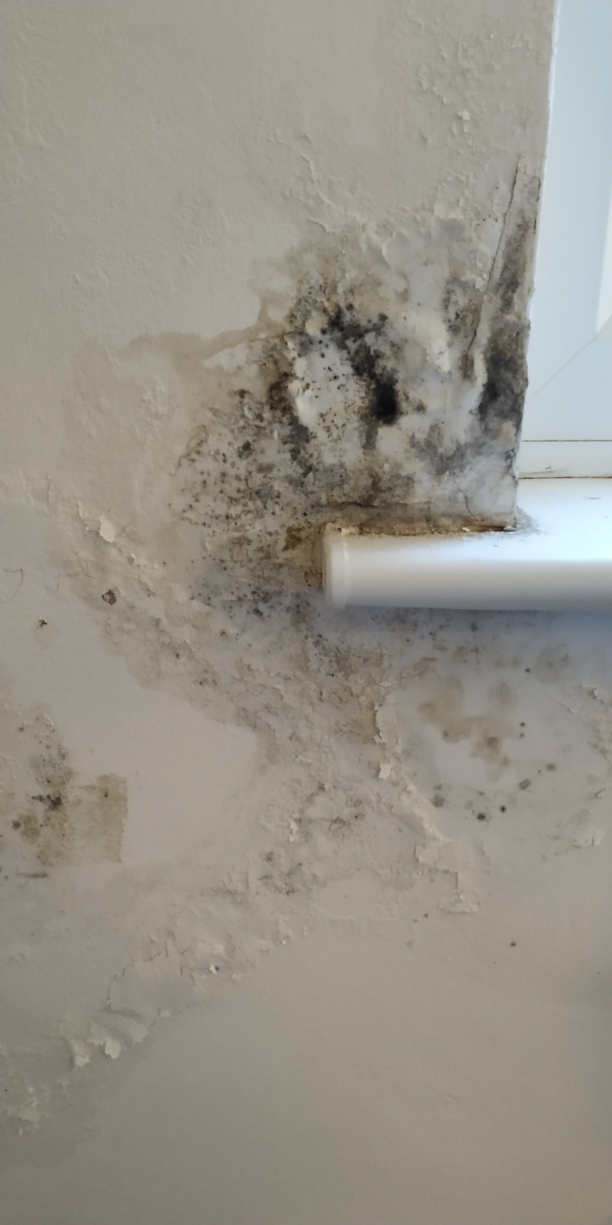

We bought a project of a house 5 years ago - new windows/electrics/decorating/rads etc throughout. It needed re-rendering as the old stuff was blown in various places & the cavity wall insulation was damp resulting in damp inside the house.
We got the insulation removed & new render done last year but are now seeing lots of issues - cracks in the main walls, cracks in the skirt around the bottom, cracks in the window surrounds, damp in 3 rooms (2 are locations that had damp with the old render), staining on the flashing etc etc
Render be cracking
Skirt
flashing
damp inside
window
We contracted a very rated local builder/renderer to do it & it was one of the pricier quotes we had. After using seemingly every sh!te contractor on every other aspect of the house we wanted this bit done properly. Due to work load the contractor subbed in another contractor to do it. He rated his work & we would still have the same garuntee. He assured us the work would be of the same quality. Oh dear
Inside the house we had a number of settling cracks when we bought it (mostly around door frames & survey threw up no major issues) which have, in the last couple of years, shown themselves again.
We want the whole thing done again but would like some thoughts as to whether the settling could have caused the damage to the render or if it looks like its just a shoddy job.
If a shoddy job - what could have caused it? wrong mix? too hot? Would be good to get an idea what people think might have caused it so I've got a better idea of what I'm talking about rather than just saying 'its obviously sh!t mate & needs re-doing'.
Also good to know what we could expect regards damage for the damp - its going to take months to dry out which is stopping us decorating.
Thoughts & feedback very much appreciated
Cheers

Just a quick note. Your house has a cavity wall by the looks of it.
One picture shows the damp coming into the house by the window. The render is butting straight up to the frame. Plastic and render have differing expansion coefficients, the water obviously comes in on the gap between the two. We had water coming in similar on our single walled 200 odd year old house, between the stone and wall for similar reasons. I figured it out pretty early on, when we moved in. I just used a multitool with cutting dish to make a gap around all the windows and resealed them. You'll probably need to do the same. Here a lot of houses have been rendered over the stone and I noted all are cracked. Most people are removing the render these days and insulating inside to keep the insulation factor.

It looks like you may have an issue with condensation building up behind the render.
The marks on the lead flashing look like rust from fixings holding the render beads on or render lath if they used it. When fixing render beads to any external surface you need to be careful which fixings you use. Even galvanised fixings will rust if you damage the galvanising during the fixing process.
If this is condensation building up under the render this can be tricky to overcome, if you seal a house externally you don’t allow the external skin to breathe, this will move the dew point from the face of the render to the nearest point where the temperature changes.

It's a cavity wall so the damp inside wall is almost certainly from condensation. The render waterproofs the outide so there's nowhere for the damp to go.
Forgetting issues with the render for the moment if you want to have dry walls I suggest insulating the wall on the inside with an insulator with a vapour barrier on the inside. The insulation will keep the temperature of the inside surface above dew point so no condensation and the vapour barrier will stop damp getting into the insulation/wall and condensing wherever the dew point falls. You said you need to decorate so now is the time to do it.
In my 30s house with solid walls, insulating on the inside has resulted in the walls being dry both inside and out.

So possibly condensation between brick & render? would that point to the mix not being correct ie it can't breathe? I'll try & get a break down of the profile but IIRC - brick>cavity>brick>misc liquid>mortar#1>mortar#2>dash
I think the misc liquid was put on the bricks before applying the 1st coat
@Edukator
2 of the 3 damp patches are downstairs (living room window as per pics) & above the kitchen window. Both have either obvious cracks in the surround (kitchen) or 'gap turned green' (as per pics above) in the middle of the damp patch ie channels/opportunities for water to get past the render & follow the window frame to get inside (at least to my mind). All patches get worse during & after heavy rain.
We only need to re-decorate the damp patches rather than whole house & have zero funds available for insulating the whole of the inside of the house :/
We're hoping that once dried out we just stain block & paint, plastering if absolutely necessary
Thanks again all - much appreciated
