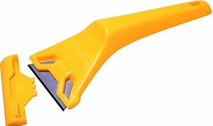

As above, Stanley blade in one of these: [img] [/img]

Was hoping to avoid using a blade, as previous attempts left scratches on the glass. I think it's got some sort of coating on it. Forgot to mention WD40; that didn't work either.

Window scraper bladeis easy to scratch glass if youre not careful. Remembe to use plenty of water to glide easily.

I used one of those scrapers stevied recommended very recently and it worked perfectly. I just took it steady at first to ensure I wasn't scratching anything but it was fine.
Posted : 18/04/2016 11:35 am
Those scrapers are for halogen hobs, which are glass, so should be fine so long as you take your time.
