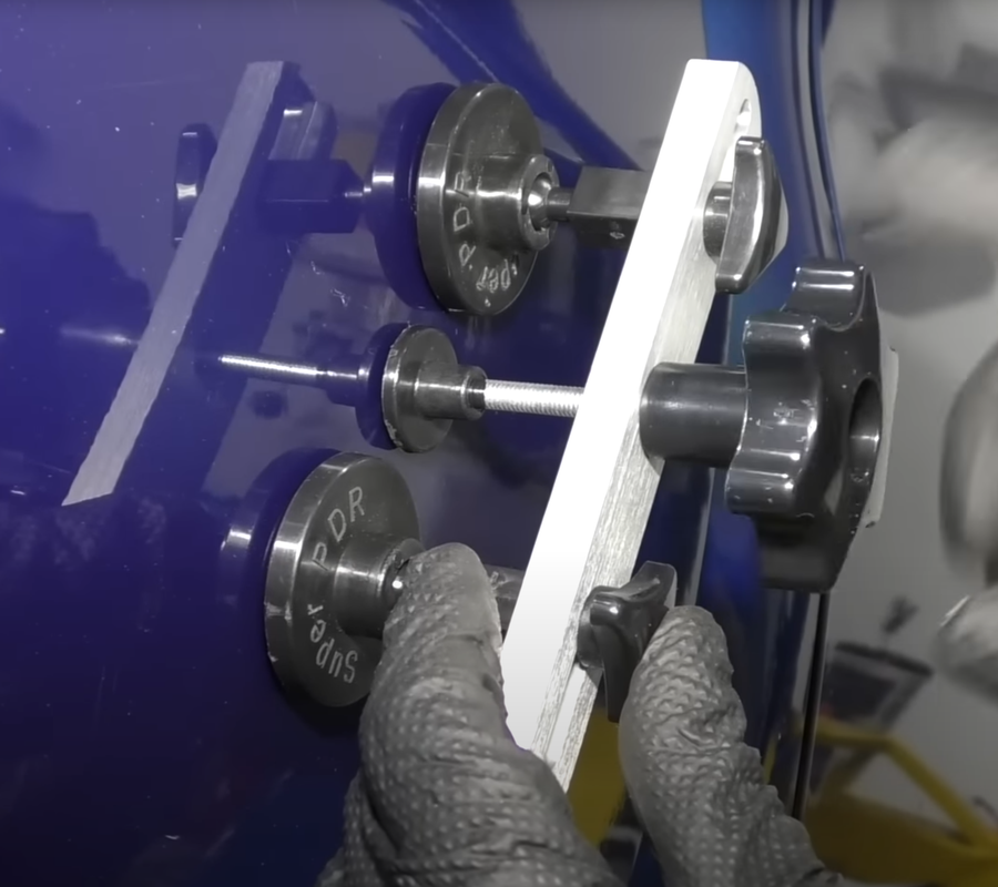

I have two little, gentle dings in the side of my car. Both about the size of an old 10p and neither with paint damage. The professional Dent Doctors seem to be about £100 to fix them so I had a quick google to see how it was done. A lot of it seems to involve hot gluing a round thing to the middle of the dent and pulling it.
There are a selection of ways it can be pulled varying from a bit of wire to a slide hammer to the thing in the picture below.
That looks fairly simple to make as it is just two pads at each end that rest against the body to support it and then a threaded bolt that does the pulling. So far, so easy. I can knock up something like that from some scrap wood and stuff in my garage but I am a bit puzzled by the hot glue. I guess you just wipe the paint clean with alcohol/panel wipe and stick a blob of hot glue on but is that really strong enough?
Id it a special super strong type?
Any ideas?
I will practice on one of my shit cars before doing on my new Porsche but anyone bored enough for it to be worth me videoing it?

Something to try at the weekend then. Need to get on Amazon for PDR glue sticks I guess. How hard can it be?

Ive seen it done, melt the end with a lighter, stick it on the panel, wait for it to cool, then yank on the stick itself to pull the dent.
If that doesnt pop it back though, i would get someone else to do it. the pro guys can be really impressive, the scale of dents they can fix, and how factory perfect they can get them. Not worth faffing about with.

You can get kits on amazon/ebay that include everything you need to have a go for 30 quid or so. Suggest OP looks on youtube for guides first and prints out a card with lines on it (you will see what I mean on the youtube guides) so you can use the reflection to see the dent.

This is one of those jobs where it is 1% tools, 99% knack.

Just to give the worriers something to mock, I can show you the last dent I have ago at.
[url= https://i.postimg.cc/50MQSjV5/Leaf-Crunch1.pn g" target="_blank">https://i.postimg.cc/50MQSjV5/Leaf-Crunch1.pn g"/> [/img][/url]
[url= https://i.postimg.cc/4dJN3cG0/Leaf-Crunch2.pn g" target="_blank">https://i.postimg.cc/4dJN3cG0/Leaf-Crunch2.pn g"/> [/img][/url]
Please bear in mind that this was a car I didn't care about, was only done for fun on a Sunday afternoon and the final phot has the paint before it was polished up but I won't deny the patinated texture of the panel remains. I plan to use this bit of the car to practice the new approach.
[url= https://i.postimg.cc/4yRCdkpx/Leaf-Crunch3.pn g" target="_blank">https://i.postimg.cc/4yRCdkpx/Leaf-Crunch3.pn g"/> [/img][/url]

I’ve pulled dents out of panels on modern vans with suction pullers, the steel is thin and flexy.
Tried it on my 951, forget it. The steel is far too thick/rigid in construction.
Not sure about hot glue or the age of your Porsche unless it’s a large flat panel, it might be a struggle.

Ive done this many times on large and small dents
Just used a normal glue gun and normal glue
I like to glue the base of a small wooden hammer to the middle of the dent and hold it there while the glue cools
Then yank it hard
The hammer will come away and in doing so pull the dent out

I chickened out and have a dent guy coming round tomorrow for £80+vat

It was interesting to watch him work his magic. It was all done with long metal stick with flat or round bits on the end which he pushed up from the inside to push the dent out. He did the front wing in about 20-30 minutes and I really cannot see where it was dented, even though I had left some blue tape on marking the spot.
Slightly less impressed when he said he couldn't get the one on the rear wing out without having the interior trim all removed first. Not something he was willing to do or willing to wait while I did it. And the £80+vat was for call out and the first dent, it would have been another £80+vat which wasn't quite clear on the conversation when I booked him.
