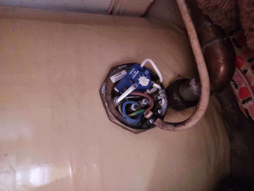

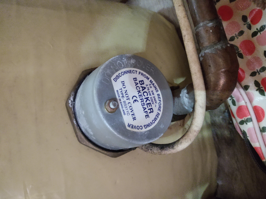

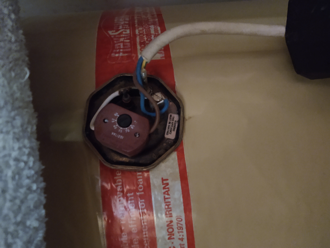

OK, so no hot water and suspect the hot water tank elements have gone. There are 2 - one half way up and one at the bottom. I assume one is for the 'top-up' immersion, and this also doesn't work so guess it went a while back. Main one I'm guessing has just failed - they're both 10+ years old.

To third the advice, check the thermostat(s). It looks like the blue one is a replacement one, the brown/red one looks older. A cheap fix if that's so as Screwfix keep them.
