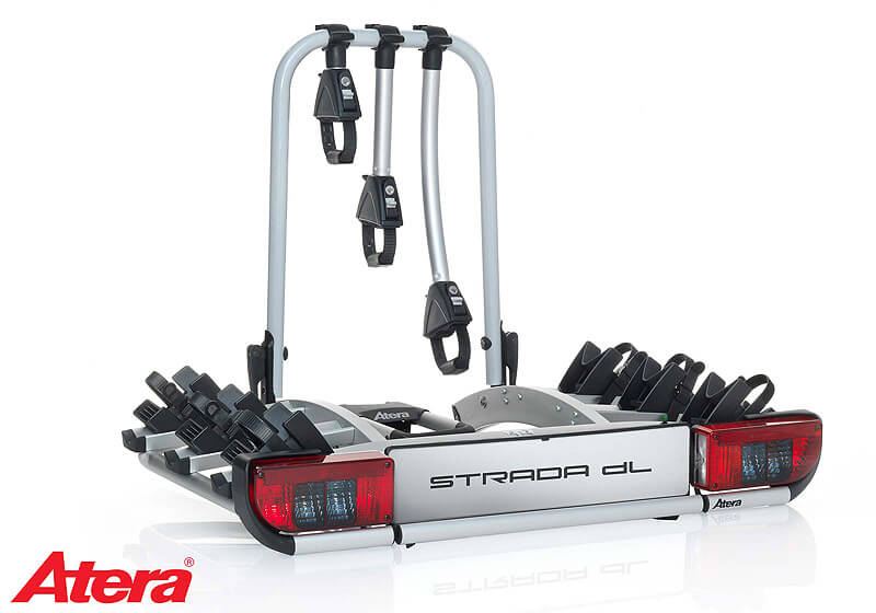

It occurs to me though that any play in the interface, while not being an issue if used to tow a trailer, could be a problem with a bike rack cantilevered off it.
not an issue when you use it properly (within the weight limit)
been using a Witter removable bar with an Atera rack like below for four years and no issues
Posted : 30/11/2014 7:58 pm
