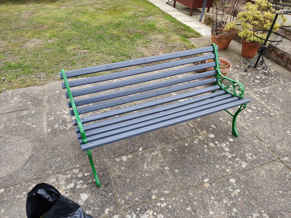

Pine slats routed to curve the edges and then sanded - could have just used courser sand pap[er to round them - stainless steel replacement bolts and fresh paint on the old bench ends.
It was a little flexy when I took this picture so I added a strip of flat 2cm wide steel in the centre just screwed into the slats from behind and it has been fine.

@WCA
Theres usually a metal strip like brace running from the lower leg stay to the underside of the slat to prevent wobble(parallelogram) one on each side and the central metal strip is normal on these benches too.

Dyna-Ti - There is a length of threaded rod you cannot see in the photo pulling the two sides together instead of the side braces you refer to. It works fine and matched what I had spare in the garage
