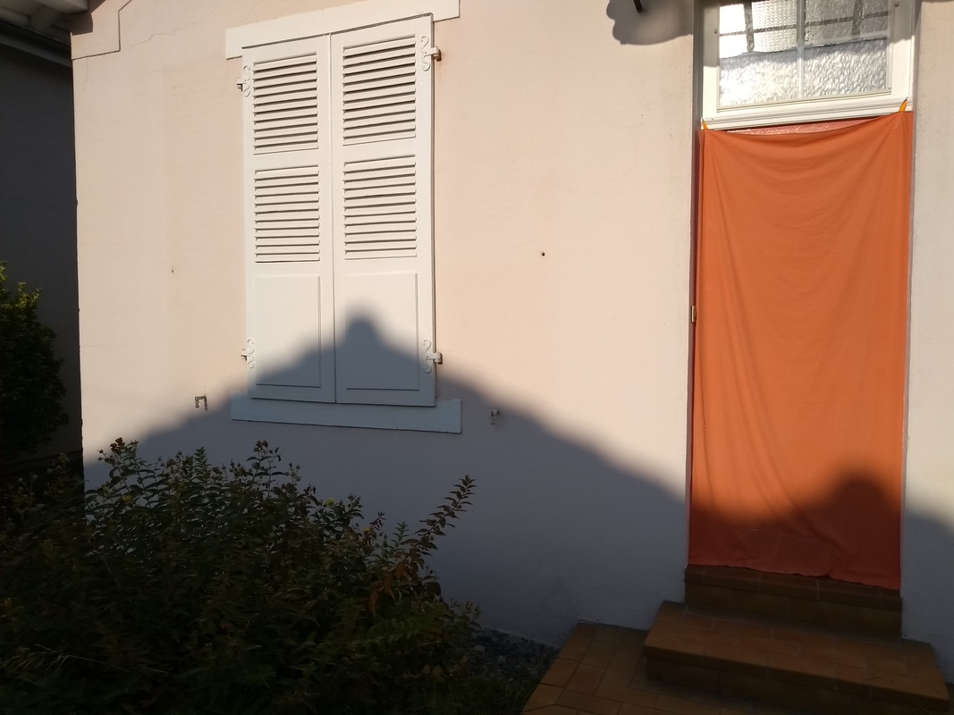

there is a reason most houses in hotter areas have these:
Posted : 13/03/2023 1:31 pm

Once again, our European friends have this covered. Literally.

It gets quite warm here in Summer so wee have light coloured walls, insulation on the outside, shutters and a curtain on the outside:

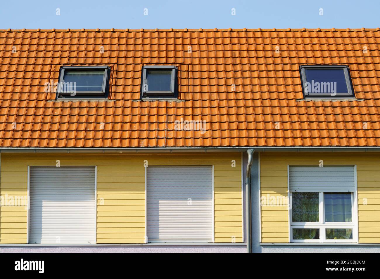

Posts: 683
Are there 'lite' versions that don't double up as some kind of security layer, and are a fraction of the cost?
Maybe that's an Ikea roller blind glued to the wall and replaced each year!

These window awnings look like the kind of thing.
Put in the window recess dimensions and it's £174 compared to £255 for the roller shutter type.

^beaten to it.
The more expensive, and rather security looking ones, are much more durable and repairable. And many are electric powered, and designed to fit into recesses of beams above windows.
