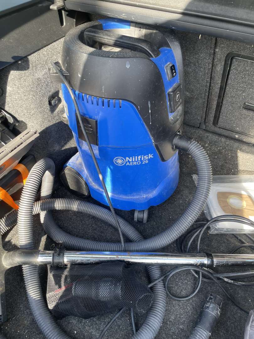

Well,  Facebook has come up trumps today. I managed to find an Aero 26 with all its accessories and some spare dust bags for £60. It’s been used by a couple doing up their house for the last year or two and seems like a wipe with a damp cloth will bring it back to looking new.
Posted : 10/07/2025 6:20 pm
Murray reacted
Posts: 957
Total bargain! Looks in really good nick and they haven't lost the tools like I did on day 2 😂
