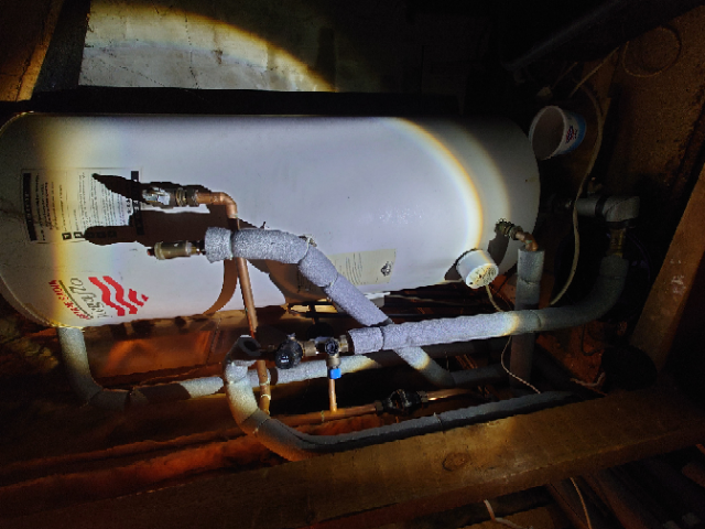

Apologies if I'm unclear - this is what I've done...
1. Close isolator valve on the main water inlet to the megaflo cylinder (in the loft)
2. Run downstairs, open lowest hot tap
3. Hot water flows out for 1-2mins and then it stops
4. Leave hot water tap open
5. Back to Megaflo and turn a blue valve knob but the tun dish, and water flows out the Megaflo into tun dish
6. Keep blue valve open ...
But water just kept flowing for 20mins, so I stopped and seeking guidance!
Posted : 21/01/2023 3:11 pm

There are two relief valves on the Megaflop. Make sure you’re turning the correct one.
There are videos on YouTube which walk you through the process.
Posted : 21/01/2023 5:42 pm
Posts: 13916
Are there?
There's only one on my two.
Right, this is mine.... Fairly self explanatory I hope.
https://photos.app.goo.gl/nP3f1JXjAe7SZ9Tz9
Posted : 21/01/2023 5:51 pm

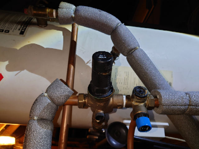

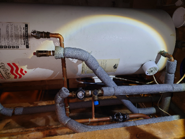

@Aus
I've just watched a video re "servicing" (almost laughable) and there were indeed two valves, a blue T&P valve and the black non-return valve.
On both my tanks (different houses and different installers) I don't seem to have a T&P valve (I'll check), just the non-return valve as in the photo I shared.
For nearly 20 years I've recharged the airgap using the non-return valve.
The blue T&P valve in the video was further down the tank and being used to drain the tank down.
Sounds like that's what you were doing.
The black non-return valve is on a pipe that connects near the top of the tank (as seen in my pic)
Posted : 21/01/2023 8:10 pm
Posts: 13916
lowest hot water tap on and then open valve by PRV for water to flow out the drain pipe.
Just reread your original post and saw this. I think you're opening the wrong valve.
My money is on the blue valve being connected further down, which would obviously allow me all the water above that connection to drain out of the tank to that point!
The valve you're looking for is connected no more than about 30cm down from the top of the tank and will obviously only allow a much smaller amount of water to run out.
Posted : 21/01/2023 8:14 pm
The Valve on the tank is the Temperature/Pressure relief valve (TPR).
The other valve is just a pressure relief valve (PRV) for the cold water inlet.
The lower (PRV) valve on sharkbaits second pic is the round black knob just above the circled valve lever. It's not a non return valve. The PRV's main function is to protect the cylinder in the event of a failure of the pressure reducing valve. The TPR valve works in the same way but it also has a thermocouple built in for releasing water if the temperature gets too high.
OP, is there an expansion vessel external to the tank? Megaflo cylinders have a dip tube in the top of the cylinder which can be removed to give extra capacity by removing the expansion gap. If that has been done then there will be an external (white) vessel installed. This could explain why you still have water coming out. When you recharge a Megaflow normally, with dip tube installed, its the water level reaching the bottom of the dip tube (200mm -300mm approx iirc) that gurgles when recharging it. All that is happening is that you are creating an air space above the water in the tank which allows expansion of the water when it is heated up.
Posted : 21/01/2023 11:17 pm

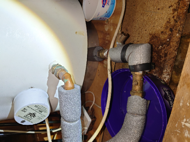

Hi, and again, thanks for the support. Sorry, couldn't pop in yesterday to look and get pics, but I'll be going in tomorrow so will do that then.
Sharkbait (and others) - think you're right. From memory there's a blue valve, halfway down the tank, on the balance valve near the tun dish, I've been turning this and I think you're right that I'm just emptying the tank.
There is, I think, a 'pull lever' type valve release on the the pipe that enters/exits the tank highest up, so figure I should be pulling this.
Also, to isolate the tank, the isolator I've been turning is the lowest placed pipe feed/exit to the tank, and wonder if this is the drain and not the feed. Presumably if I turn the mains stopcock off, this will do the isolating job ok?
Still trying to get a plumber in for her, but mostly, none return my call, and none interested!
Will update tomorrow with pics, but I (and she) really appreciate the help.
Posted : 23/01/2023 10:17 am

OK, so I've just been round again, and suspect turning off the mains water is not the obvious stopcock, there seem to be 2. So with both these off, the low hot water tap ran out after 1-2mins. Went up to the cylinder and opened the lever valve uppermost on the cylinder - I think this feeds hot water to the tun dish - as I opened it, a brief whoosh of air momentarily, no water drains out to the tun dish, no gurgling, no further intakes of air.
Shut the lever valve, turned mains back on, hot water spluttered out the low tap for 30secs and then steady flow.
I'm guessing that it's not fully recharging?
But thankfully, have eventually got a plumber who'll come next week as the drip is is still there.
Thanks for all the help.

Dripping from the large central black valve ...
2
The blue knob seems to simply release cold water into the tun dish, so not the pressure valve?

This is the uppermost lever pull valve ... pressure release valve?

I thought this was the isolating valve, lowest cold pipe ...

Posts: 13916
I'm at a loss. It looks a little strange but maybe mine are set up very simply!
I think you're right in the location of the cold supply to the tank and the lever valve (although different to mine) looks to the right also.
The insulated pipe next to the immersion is either the feed from, or return to, the boiler - the other one seems to be further up the tank (with the red bleed valve?) ..... mine are next to each other at the bottom.
I'm guessing that's a pretty old tank as mine have a sleeker looking immersion unit. It's also quite a small tank which confused me for a minute as the lever valve looked too low, but it's not.
I don't have any more advise - sounds like you've done the correct procedure so maybe there's a failed valve.
IANAP obvs!

Thanks again for all the input ... the plumber finally came - couldn't find an isolation supply valve/tap, so he'll fit one, plus replace balance valve, hopefully this week. And then hopefully it'll recharge! I'll update once he's done...
Posted : 06/02/2023 9:33 am
Posts: 13916
That lever valve looked well dodgy - I'm sure that wasn't OE!
I'm sure you were right about the location of the isolation valve - it was just a slightly weird place to put it and the installer obvs didn't have the right parts so made do.
Posted : 06/02/2023 10:05 am
 Aus
Posts: 1522
Finally all sorted - plumber thought some of the placement of valves etc was odd, and the isolation valve was downstairs and didn't work, but he's replaced the balance valve, put in a sensibly placed isolation valve and all seems to be well ... thanks for all the help. Neighbour much happier!
Posted : 16/02/2023 11:08 am
