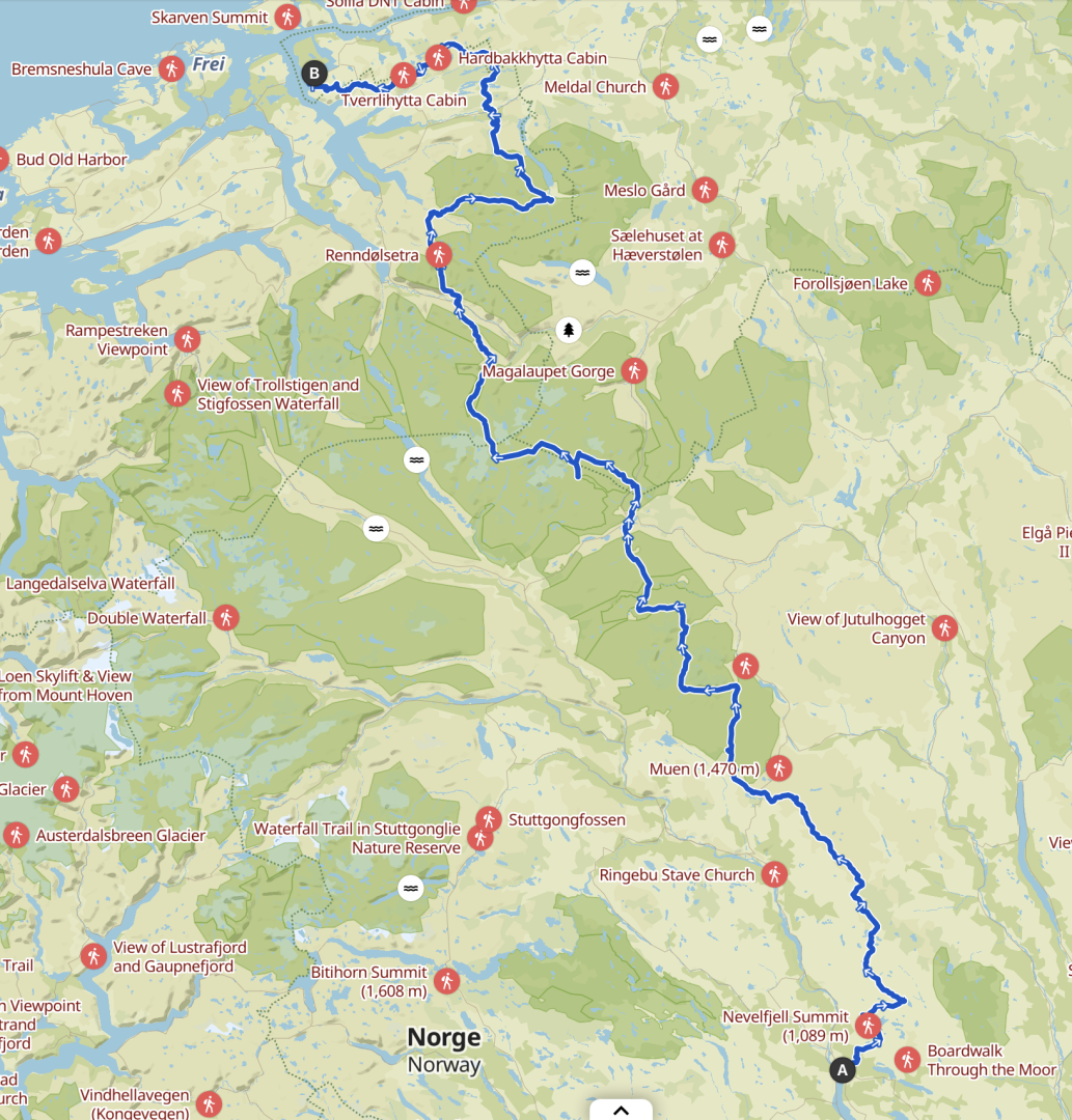

I've been a DNT member for a while now, and they are indeed extremely helpful. I spent an afternoon in their place in Kristiansand earlier this year, and I'll go to the Oslo one when I'm next there.
I've attached a screenshot of a very rough outline itinerary from Komoot, which gives some sort of indication of the route. It will however have to diverge quite a bit from this cabin-to-cabin route as we're going to need to take detours to towns so we can find food that isn't just the tinned lapskaus, sodd and bacalao that they have in the DNT cabin larders 🙂
