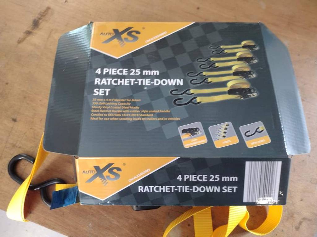

I've got some expensive ones, but recently bought some on impulse in the Aldi aisle of dreams for much cheapness.  They are surprisingly good quality.
