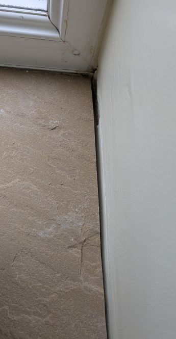

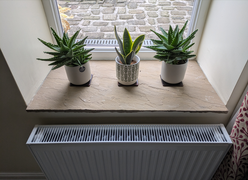

Thread revival time. After the purchase of an angle grinder and a fancy pants diamond disc, I set up my cutting table and my hosepipe again and had another crack at it and.......
ta-daaaa!
There are some gaps around the edges. It turns out that, although I'm impressed with myself for getting it bob-on the same shape as the old sill, the old sill wasn't a great fit. I'm all for leaving them (to let it breathe a bit, cos of the damp issues that got us here in the first place), but MrsIHN would prefer them filled. Rather than bunging it up with silicon, is there a breathable gap-filler that looks decent?
A gap earlier...
Posted : 04/09/2025 8:09 am
Looks nice.
For the gap filling, I might go with a small wooden bead painted to match the walls if you don't want it sealed. Which sounds like a sensible approach.
Posted : 04/09/2025 8:23 am
Posts: 19694
Hmm, beading eh...
Posted : 04/09/2025 8:43 am
Posts: 6071
You could try for a matching tile grout, just don't smear it everywhere so use some tape
Otherwise, a bead or flat strip (rather than a more trad glass bead) on the wall and painted white. The problem then is that you'll have gaps under the flat bead 😉 https://richardburbidge.com/shop/mouldings/windows
Posted : 04/09/2025 9:32 am
Posts: 19694
Posted by: timba
Yeah, good point.
What about good old boggo Polyfilla, is that breathable?
Posted : 04/09/2025 9:44 am
Posts: 6071
I'd leave it as is. You can only see the gap because you know about it; nobody else will notice. White filler will look like a poor paint job
Posted : 04/09/2025 9:49 am
 Olly
Posts: 5169
First time ive seen this thread. looks brilliant, considering you were going to cap some crappy fibreboard.
well done!
If it were me, i would leave that gap. Its hardly the grand canyon, you wont even notice it in a weeks time, and it lets the damp breathe better?
Posted : 04/09/2025 9:50 am
Posts: 19694
Posted by: timba
Someone has noticed, and I'm married to her
Posted : 04/09/2025 9:52 am
Posts: 1000
Nice job. Unlikely that any of your surrounding materials are breathable - emulsion and UPVC windows. I think  you are asking a lot of a tiny bead of filler to provide much in the way of moisture transport. What did you bed it in with? I'd just use whatever filler you have.
Posted : 04/09/2025 10:00 am
Posts: 19694
Posted by: robola
Oh, don't get me wrong, I'm not expecting this to fix the issue, but if I can avoid trapping any (more) moisture under there then that can only be a good thing.
Posted by: robola
Nothing, it's loose, just sitting on the splats of dried grab adhesive that the old one was stuck down with. Well, I say 'loose', it probably weighs 20kg so it's not going anywhere.
Posted : 04/09/2025 10:19 am
Posts: 1000
If you really want breathable you are probably looking at lime based, you could try a casein filler - https://www.limestuff.co.uk/fillers/volvox-filler-500g-565
Posted : 04/09/2025 10:42 am
Looks really good.  I would run a wooden bead around the edge if it were mine
Posted : 04/09/2025 10:59 am
