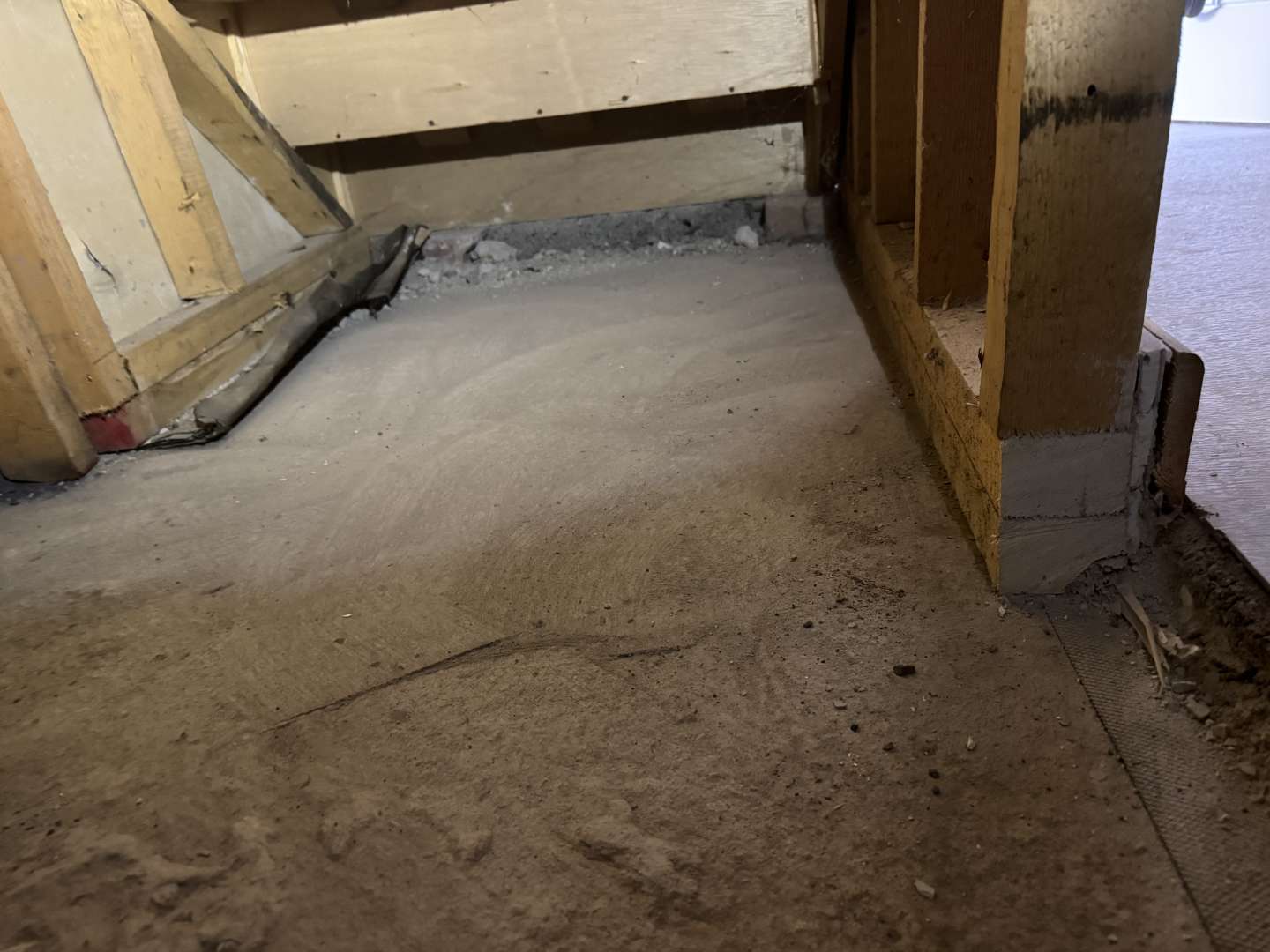

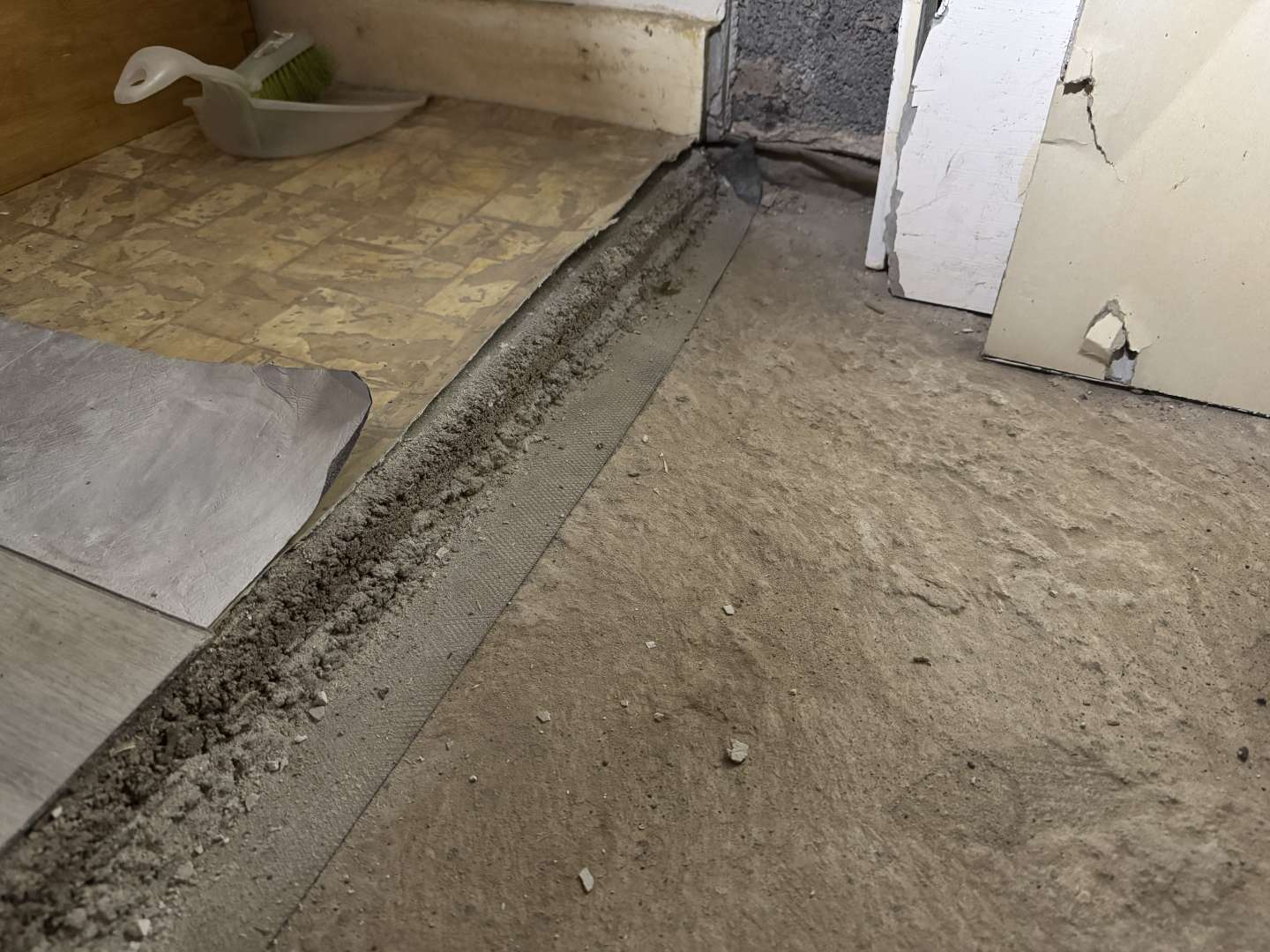

IMG_0950.jpeg Kingspan and board over the top sounds very tempting. Cleared it out this morning so some pics for reference. I don’t see how I can seal new dpc membrane to the existing as it doesn’t come out from under the wooden frame.

based on the photos I'd be really careful about putting a membrane down. You could easily trap moisture against the footings of the staircase. Looks like its a bitumen dpc. Potentially put some simple formers (10-15mm thick boards) around the footings when you cast anything, with the bitumen folded gently up. Then remove them to provide an air gap. You can bond the new membrane to the old (either by heating the old or using foil tape). It's a bit trickier than first described.

Thanks very much - I’m working on removing the rest of the studs then I’ll be able to get to the membrane to bond to it. Not a problem to leave a decent gap by the foot of the stairs - the other side is just a frame for some more plasterboard so not structural but I’ll avoid that too.
Looks like I’ll need a few bags of levelling compound to fill the space which is a shame.

Looks to me like they didn't extend the screed over the structural slab where it goes under the stairs.

There looks like 50mm to catch there and that would take ages and huge cost using self levelling
Paint it with bitumen if your worried about dampness then a 4 to 1 screed not wet but slightly wetter than semi dry, plastic float is your tool not a metal float
The edge that's there will probably be curling up a wee bit but get rid of any floor covering in the way so you can see what your doing, long straight edge and get it level as best you can
If it's looking slightly rough as you've never done it before then one bag of self levelling might make it look acceptable or just get someone who works with cement and knows what they are doing
