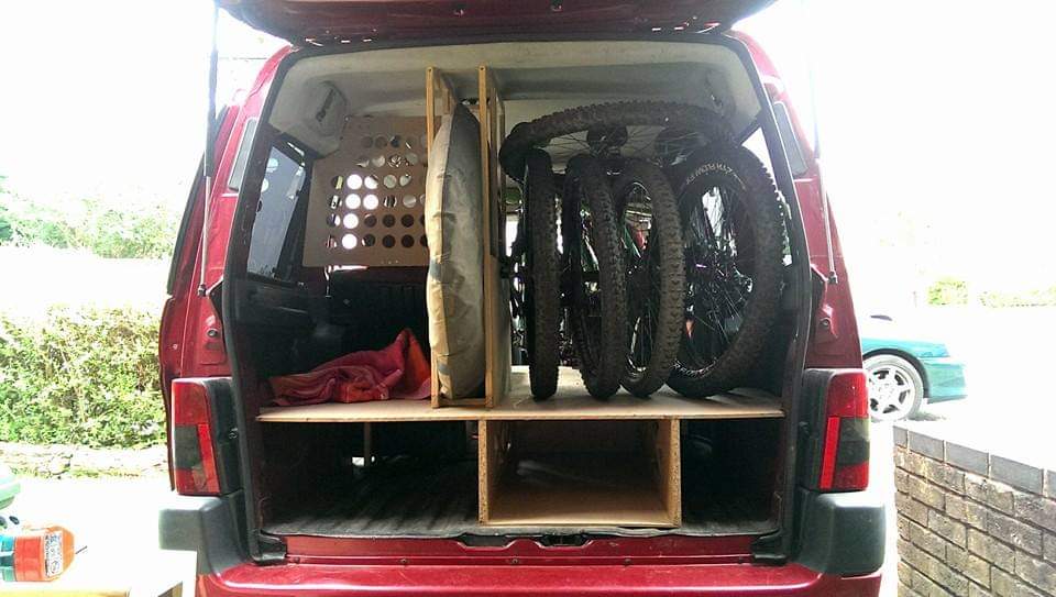

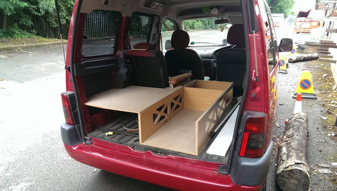

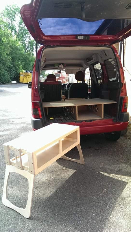

I did pretty much that in my old Berlingo for a 3 week euro road trip.
I built mine fairly tall to maximise space under there but you could be a lot more minimal. I incorporated a pull out, folding picnic table in mine too which was great for the 3 of us.
You just need ribs going long ways to support your base and then some sort of pull out drawers so that things don't get stuck miles away out of reach.
I would build up your support ribs to the level you want, and then use cardboard to get the floor shape, then maybe 9-12mm mdf/ply on top then carpet.
Posted : 22/04/2021 2:14 pm
Posts: 4315
That looks really nice. Like the table idea too. What thickness ply did you use for the floor the bikes sit on?

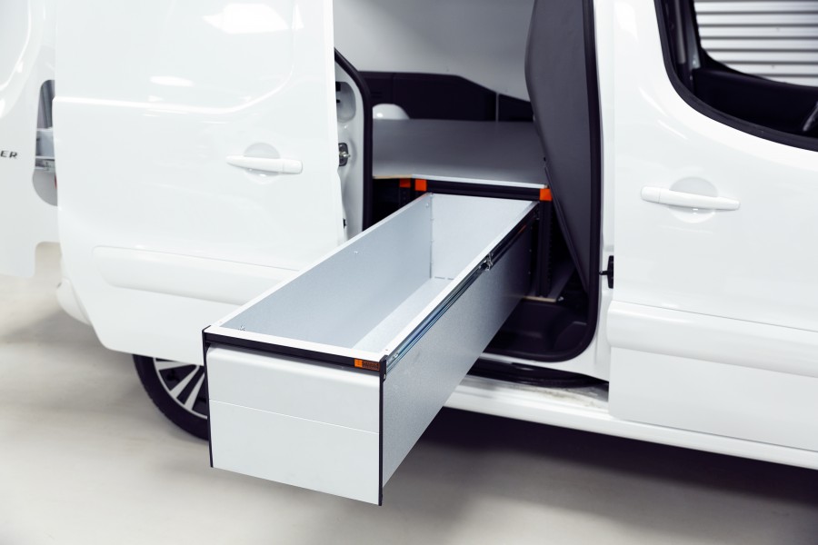

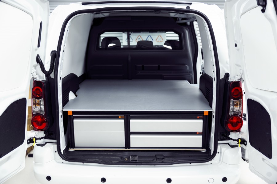

Something like this?
I'm getting similar for my Discovery
Berlingo drawers
Berlingo
Berlingo
Posted : 23/04/2021 10:25 pm
Posts: 4315
Yes, but not as tall. In the top photo there are two low profile drawers; I'm thinking the hieght of one of those. Then covered in carpet so it's not obvious from the outside.
