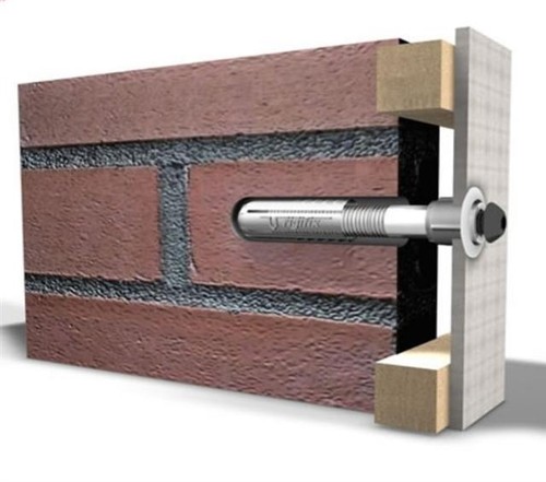

I've never found a fixing that I am happy with for mounting anything heavy on plasterboard, tried the screw in ones, the sprung Interset ones Innes refers to above, but you need to get them to seat properly.
If I am hanging something heavy, delicate and expensive from dry lined walls I find these sort of fixings are the only ones I am confident will hold. They use the block behind the plasterboard, so no weight on the board.
Not cheap but better than dropping my road bikes off the wall. About a pound each on E-bay, under the trade name Rigifix.

Thanks gents.
I hadn't thought of fixing some batton to the wall. Of course having that go through to the brick is going to be very strong.
The fixings above is what I was thinking of, could be worth a go for the lighter stuff (I want a rail to hang my riding kit on).
