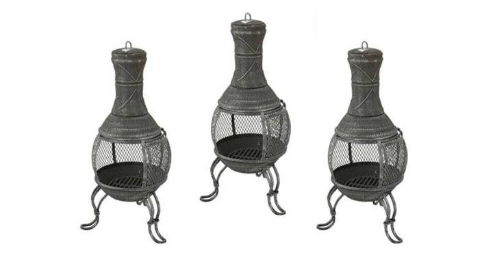

ElShalimo - Member
Has anyone used one of those Machine Mart pot belly stoves in the garden?
For the garden you're probably better off with something that's a bit more open such as this from Argos.
They're actually fairly weighty. I have one on my allotment. Been there a couple of years.
Posted : 09/05/2017 9:08 am
