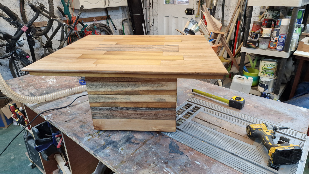

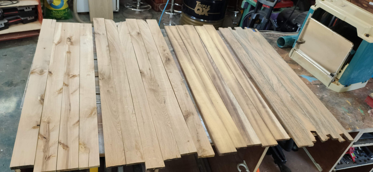

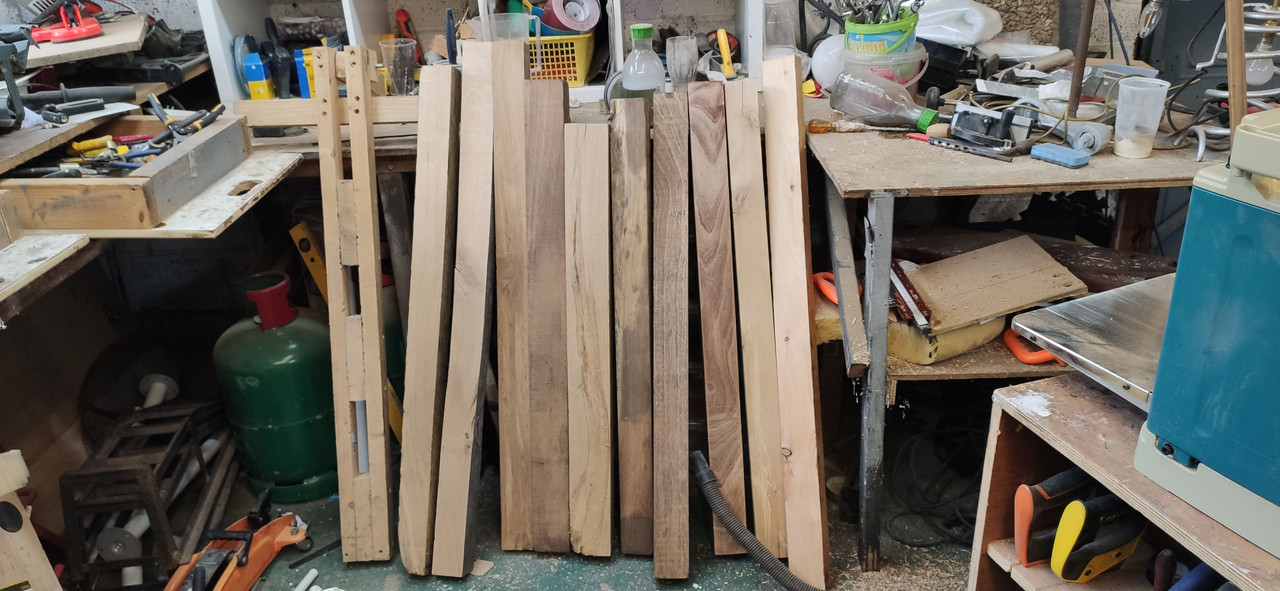

Showing £389 here too. Great tools to have. I coughed just over £500 on my Makita earlier this year (paid for by a selling a painting) and am amazed how much I use it. I simply buy battered lumps of wood post from the scrap bin at the timber merchant, use the table sa to cut them into rough planks and the the thicknesser makes properly useable timber.
I am sure proper wood workers will tell you the full benefits but for me I spent £30 buying this 'waste' timber. The p[hoto is after I had passed it through the thicknesser a coup0le of times just to be able to see the raw wood and try to identify it.
I turned it into planks first and ten some furniture. A quick check around the furniture shops shows I saved more than £500 so the thicknesser was free, right?
