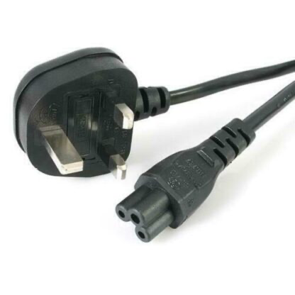

(+ £35 for the kettle power cable with a slightly modified plug, which I don’t believe I need).
That's not a slightly modified plug, it's an IEC C5 and is very much a standard. They're common as muck, that would still be an obscene price if they moved the decimal point one to the left.

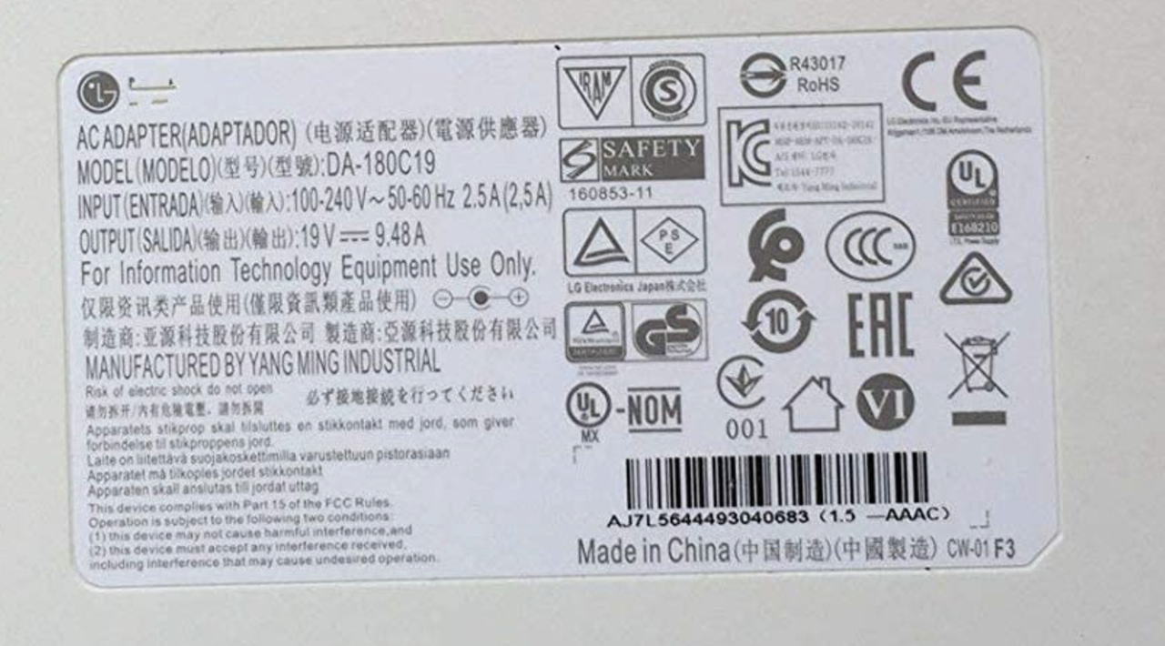

Can’t find the specs of your monitor Power Supply (a photo of it may help if you've got one) to compare to teh ones you’ve found.
PSU is an LG DA-180C19. It says 19V 9.8A (centre positive). It looks identical to this image albeit different serial number:

Not really. It's still just the same 3 pin cable but a different ("IEC C5", apparently) connector. Like this:
Anyway, I'm fairly confident the cable is fine. At least, all the connectors conduct which I think is all that it could go wrong.

Not really. It’s still just the same 3 pin cable but a different (“IEC C5”, apparently) connector. Like this:
I literally just said that!

Minor update: I ordered a 'compatible' charger from Amazon. Unfortunately, the charger is not as advertised and is only 2A not 9.5A so will power the screen but can't power my laptop (or apparently even display the screen image). Thankfully, the screen appears fine and can display an image from my Raspberry Pi, so a proper PSU should fix it.
But I can't for the life of me find an LG PSU from a reputable place (except for the ridiculous £154 option from LG direct which I refuse to pay. Is there somewhere I can buy a standard, good quality PSU from? I don't mind splicing the plug if necessary.
