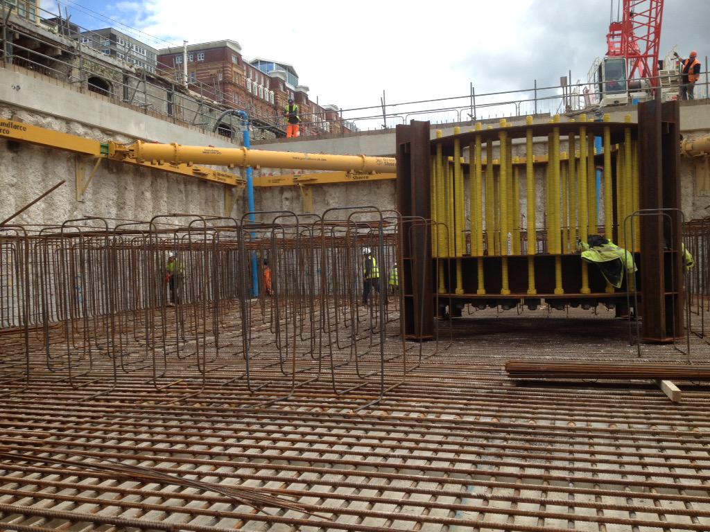

Posts: 760
One of these should do it
Posted : 22/05/2015 9:57 am
That looks a big light weight, sort of thing you'd use for a rabbit hutch. If this is a shed / man cave you really should use something bigger:
