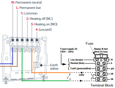

Looks like a single control wire on the videos I've watched with a link wire between com and live in the receiver.
Edit - seems to depend on the receiver.
This looks like the sort of wiring needed https://www.diynot.com/diy/threads/hive-to-potterton-28-wiring.543247/
