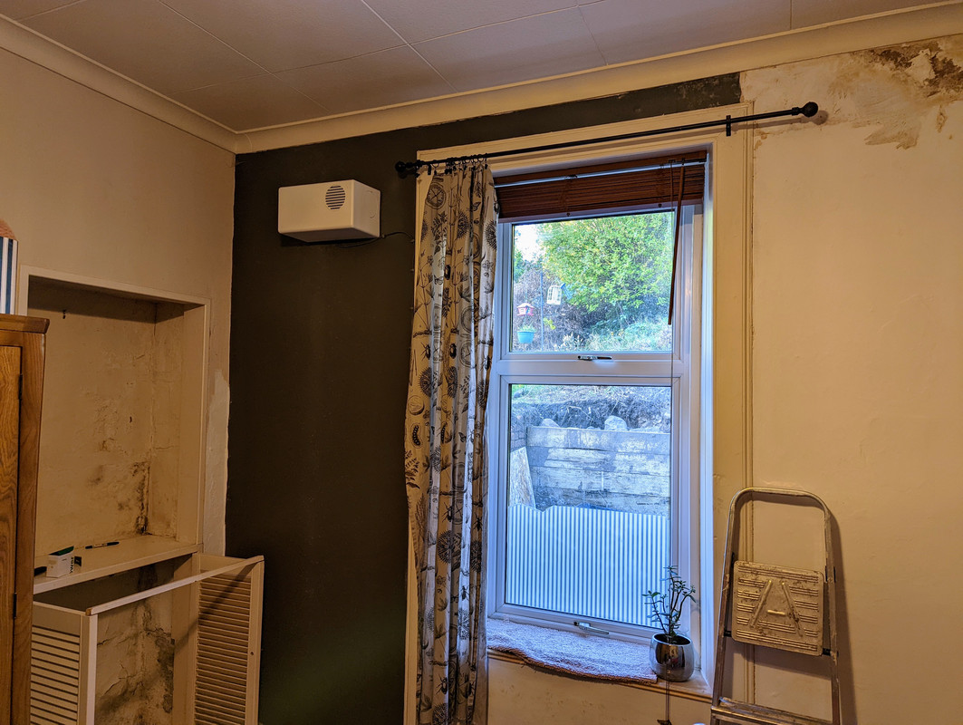

Finally got round to finishing the PIV job (had a few issues with cutting the core for the vent - involved a wee trip to a&e!)
No loft space, so this one is wall mounted, cost £300 fro the unit ( https://www.fastlec.co.uk/vent-axia-lo-carbon-pozidry-compact-pro-piv-with-integral-heater2?gclid=Cj0KCQiAkZKNBhDiARIsAPsk0WgpgETB5AU3DaqSc_VNq4fszvRuFv1bpN082bLpkveCd_tzMZyAYgQaAtAJEALw_wcB)
So far, according to my Nest thermostat it has dropped the internal humidity from 70% to 50%. Could definitely tell as my skin felt all dry!
Hopefully running this over winter can solve the damp/mould issues in the house and we don't end paying £20k for having to dig out all round the outside of the house and re-do DPCs etc

Been running that wall mounted Ventaxia PIV unit and the trickle extractor fan (with humidistat boost function) in the bathroom for about a month now, and internal humidity is down to 40%, from 70% before we fitted them. First day of running them was down to 50%, so it's dropped further. External humidity is really high just now too (80% or more according to the BBC weather).
Not seeing any condensation issues which is pretty good for winter!
Picked up a couple of Lidl humidity/weather stations to compare humidity in the bedroom and bathroom with outside (they have an external temp/humidity sensor). Readings are a little off from the Nest thermostat in the bedroom (3% difference, but these things are +- 5% accuracy anyway) but trends are all matching.
