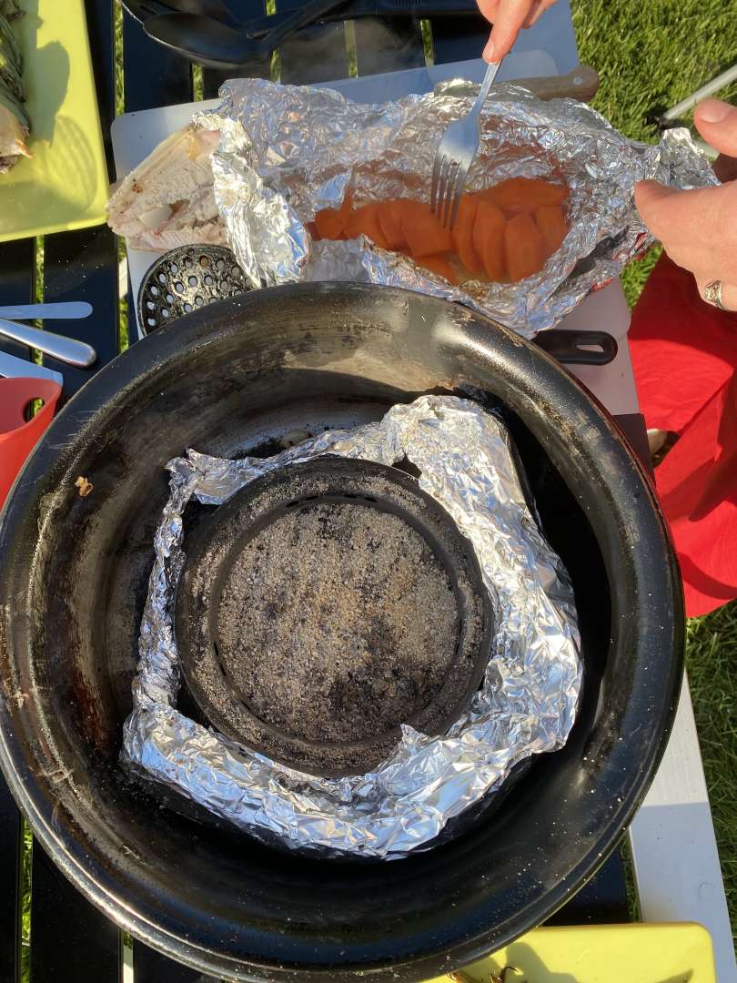

 IMG_1155.jpegIMG_1152.jpegIMG_1151.jpeg We drove over to near Richmond Yorkshire with Tabatha in tow Friday afternoon after work for the bank holiday weekend, nice quiet little site.

The reason for the food related post is that MrsRNP was a dab hand at manifold cooking on our overlander Defender, we had many the smell of delicious meals wafting from under the bonnet as we trundled along motorway and autoroutes (unfortunately the pics are pre my iPhone)

What's that in the second picture? Looks like an overheated brake drum with a wrap of tinfoil inside it. 😁
Posted : 04/05/2025 6:21 pm

Posted by: tthew
It's the 'moat' of the Cobb that can be filled with liquid to keep the main compartment moist, the fire basket is removed and scorching a waffle pattern on the grass!
Cobb cooking is similar to engine manifold cooking - two layers of tin foil with liquid inside (oil/wine/butter etc). In the Cobb they are placed round the outside of the fire basket, the chicken was on the griddle plate above.
