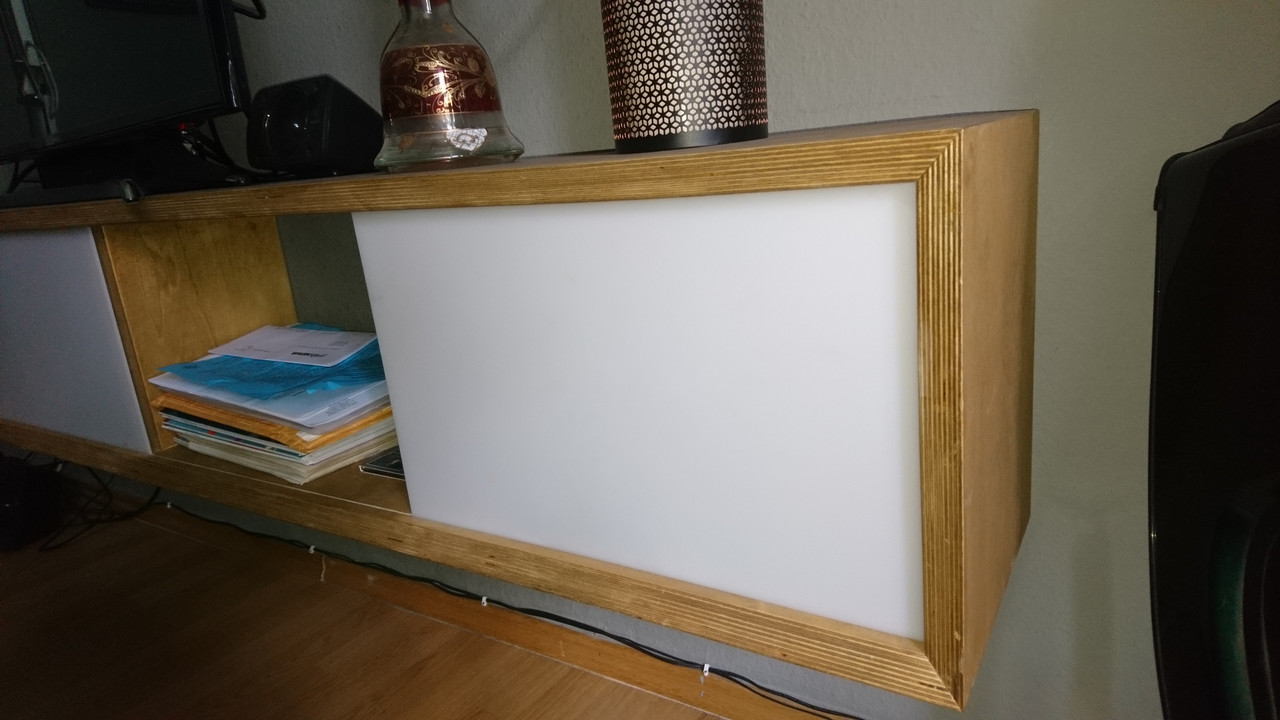

Posts: 12993
As above, birch ply.... Sometimes called Rhino board or multiplex
[url= https://i.postimg.cc/7P7L2Mvq/DSC-0012.jp g" target="_blank">https://i.postimg.cc/7P7L2Mvq/DSC-0012.jp g"/> [/img][/url]
[url= https://i.postimg.cc/sxpDCyPM/DSC-0013.jp g" target="_blank">https://i.postimg.cc/sxpDCyPM/DSC-0013.jp g"/> [/img][/url]
Posted : 14/10/2018 11:20 am

Thanks, lots of info to digest! I am looking to make something very similar to alpin
How was this joined, biscuit joints?
Posted : 15/10/2018 11:17 am
Posts: 12993
Late reply....
Just taped and glued. Couple of clamps to hold it whilst glue set.
27mm ply.
Easy.
Posted : 17/10/2018 7:23 pm

nice mitre alpin, what was that cut on?
Posted : 18/10/2018 5:27 pm

Posts: 12993
1970's Altendorf
Posted : 18/10/2018 8:35 pm
1970’s Altendorf
