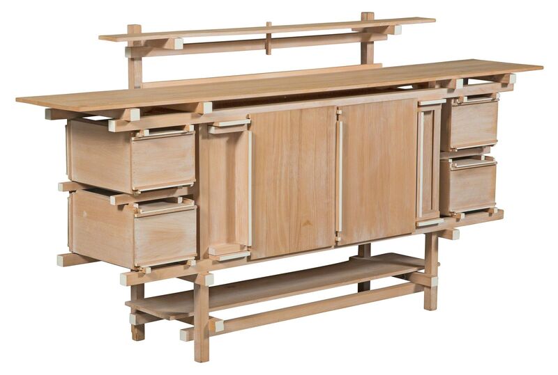

HOUSE IS ON FIRE !!..... sorry, cant deal with it,I'm gluing up.
One of my classmates made this as his final piece. Gerrit Rietveld sideboard. It was the devil to glue, and he had to loosen joints off and redo them as some of them only required small spots which dried really quickly. An exercise is patience.
Posted : 19/04/2022 2:43 pm
Posts: 14233
I'll take a hard pass on trying that
Anyway, cheers both, sash clamps ahoy
Posted : 19/04/2022 2:58 pm
Rutlands is good for Sash clamps.
Their Record copies are pretty good ime.
Posted : 19/04/2022 3:39 pm
Jesus, imagine dusting that bastard
Posted : 19/04/2022 3:48 pm
