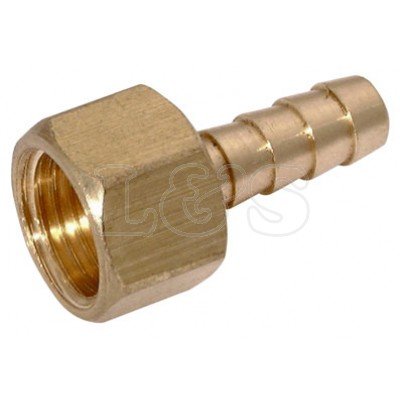

I'm trying to connect a 1/2 bsp female connector
directly to the end of a [url= http://www.screwfix.com/p/grohe-feel-side-lever-mono-mixer-kitchen-tap-chrome/75522# ]Grohe monoblock tap[/url] but the thread and size are not compatible. So I'm looking for some kind of female-male adapter that will screw onto the tap and allow the 1/2 bsp fitting to connect.
(Or even sompler - replace the 1/2 bsp hosetail fitting with something that will fit the tap directly!)

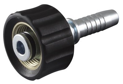

From what I can tell, (although I'll try to confirm this with your link), the tap end is M22x1 male.
I've had a look but can't seem to find a M22x1 female hose-tail that I could swap with the existing 1/2 bsp fitting.
I presume that something like would work, if it was 22x1 not 22x1.5
I honestly don't know what I'm talking about with this, so feel free to correct me if I'm wrong! 😀
