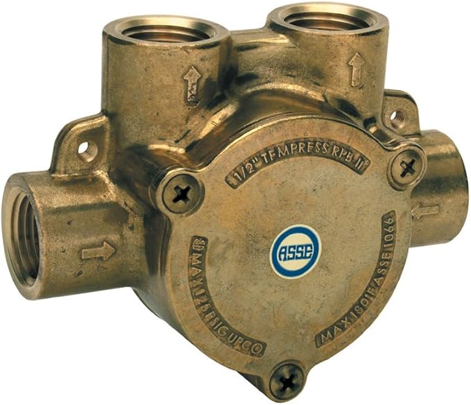

We have a pressure balancing valve for our shower. It makes a whirring noise on shower start up as it does its thing.
When we had our pipe joint burst a couple of years ago I tried to plum the shower without it - and it was like yours basically cold. Put valve in and it works.
