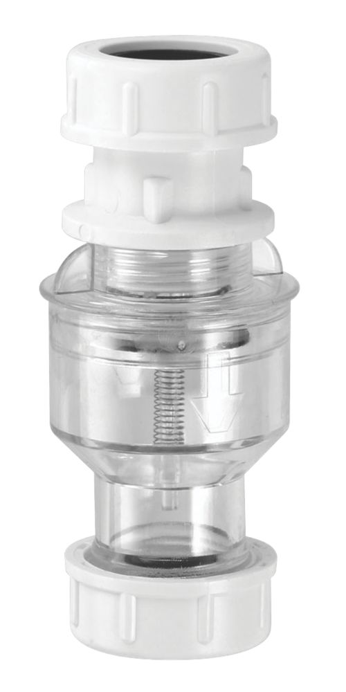

@singletrackmind, would one of these (placed vertically) before entering the soil stack via a strap boss work?
https://www.screwfix.com/p/mcalpine-tundish-19-23-x-19-23mm/5684V
Posted : 22/11/2021 8:48 am
Posts: 7167
Yes
