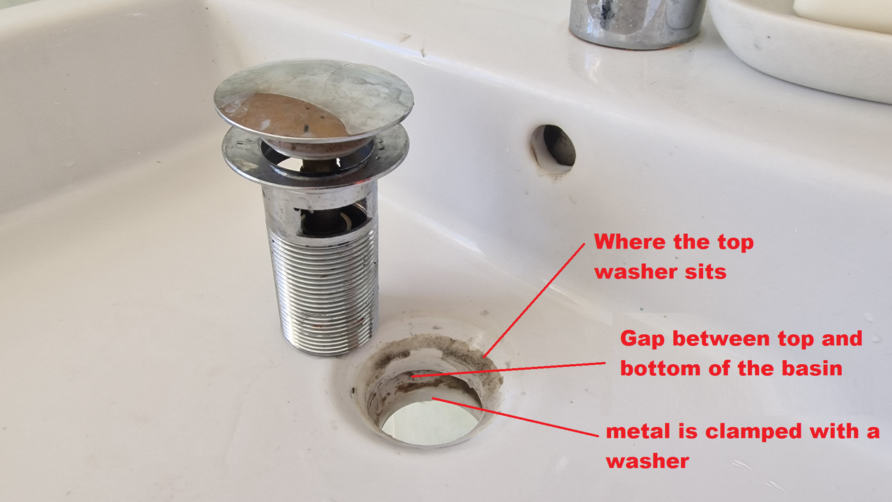

'We' decided that we needed a cupboard under the bathroom basin and once I built it I discovered that the basin leaked from the plug hole. We had assumed previously that the occasional drip on the floor was just a splash from using the sink.
I will simply replace a washer I thought. How naïve. It looks to me like the plug fitted isn't compatible with our basin but that sounds strange when I say it out loud.

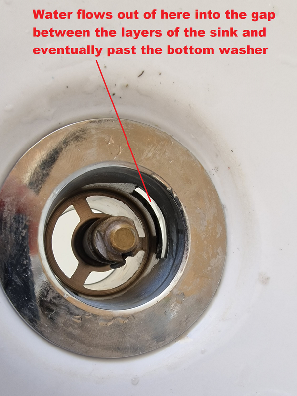

It is a pop top plug thing which works fine and allow the sink to be filled or drained (slowly) but part way down the neck of the drain is a hole. This sort of lines up with the gap between the two layers of the sink but is not level with the bottom layer so any water that goes through the hole just sits there, outside of the metal tube. This eventually finds away past the bottom rubber washer and leads to the drips.
This shows the plug fitting slotted into place and you can see the daylight through the side hole. The water is prevented from pouring onto the floor by a rubber washer underneath the sing but that just leaves the water sitting there, and as I said before, it eventually finds a way through
What is the correct solution?
New drain fitting?
New bathroom*?
New washer?
*I suspect this might be what MrsWCA would choose

Can’t be 100% but that slot in the basin is likely to be your overflow, water goes through the overflow at the top of the basin and then into a slotted waste. Otherwise the overflow has no where the drain
Posted : 17/11/2022 1:31 pm
 5lab
Posts: 7921
you just need a rubber ring between the bottom of the sink and the thing you're screwing it up with. The hole is there (afaik) to allow water from the overflow to get to the waste pipe
The slot is to allow water to flow from the sink overflow down the drian.
The gap in the sink is the built in overflow channel that takes water from the overflow hole down to the drain.
That all looks normal.
It just looks like you have a slight incompatibility between the longer metal waste and the thinner than usual sink.
I'd try with a fat rubber washer underneath lathered in silicon, or try buying another waste that has the slot hole higher up.
Or, if you're happy to lose the overflow capability (remember to turn your sink tap off!) then you could replace your waste with an unslotted one, like this: https://www.screwfix.com/p/mcalpine-slotted-unslotted-centre-pin-basin-waste/714hr

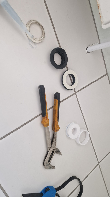

I had this exact same problem a couple of weeks back fitting a new basin. Nearly drove me crazy. I thought the leak was between the bottom of the chrome waste and the trap threads. Sealed at that up... still dripped. Then I went for between the outside of the big black cone washer and the sink. Sorted that out. Still dripped. Eventually realised the drip was coming from between the big black cone washer and the threads of the chrome waste. Turned out I was over-tightening it and breaking the seal that would normally be formed.
So, if you're a bit ham fisted like me, try loosening the massive nut underneath the big black washer off slightly before going out and buying more bits.
In my defence, the waste (which came with the tap I bought) has an unusually short thread/tail on it so there was barely much thread left to get the trap screwed on to, hence me tightening it as far as I could to expose more thread. Reviews on Screwfix (read after the fct of course) back up the fact that the tail is about 5mm shorter than most others.

I 've used those plug kits the washers came with them. It's a sort of thick spongey washer which nicely fills gap when tightenened. Make sure all surfaces are clean, even underneath. Use wash up liquid or Vaseline on rubber bits. Don't overtighten or you ll never get it off.

Okay, I get that the hole is to allow the overflow water somewhere into but the water also flows out of the hole. As the bottom of the hole is higher than the bottom of the gap between the sink layers, there will be standing water there. That seems wrong to me.
The dirt around the sink you see in the photo is just the silicon I used when I last fitted the plug that I haven't fully removed. It was, and will be again, spotlessly clean.
I suspect I had over tightened the big bottom nut last time I fitted it as suggested by pocpoc.
I will try again with a less tight approach
